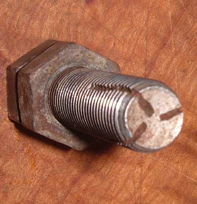

when I put a hitch on an 03, I didn't know where to get a tap to clean out the threads, so I took one of the mounting bolts and cut some slots in the end with a hacksaw. Not as efficient as a real tap, had to back it out and clean the slots a few times per hole, but then just used it as one of the mounting bolts when the holes were clean.
