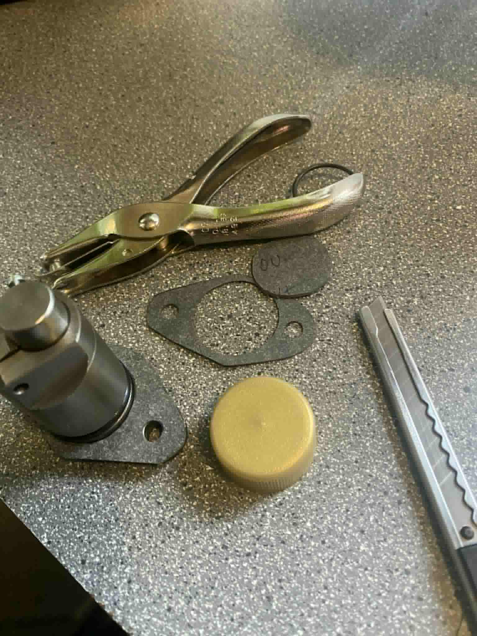

Curious if anyone has had any luck making a paper gasket for the Timing Chain Tensioner as a back up secondary seal, (in addition to) the O ring. I know the tensioner has an oil port that takes in oil pressure which assists the spring to make tension. That said, it looks like there is room for a paper seal.
Anyone have an opinion on if this will be a no.. no? I did make one that fits perfectly, and installed it with no leaks. However, I am not an engineer or Toyota Master and just because I can make the gasket, it may conflict with the part's design characteristics.
Can anyone tell me if this is NOT a good idea, and why? Thanks

Here's my take on your situation. Seeing how this is just a tensioner (not a critical machined part where close tolerances could affect performance) I don't think a few .03-.05" of gasket thickness will stop the tensioner from doing it's job. Several here simply cleaned the surface clean and applied RTV silicone to where they achieved satisfactory results also! Just my 2 cents there. Either way, good job and keep us posted here if you notice/have any issues ;)

Drove it today for several hours.. no leaks and it seems to be doing fine.
