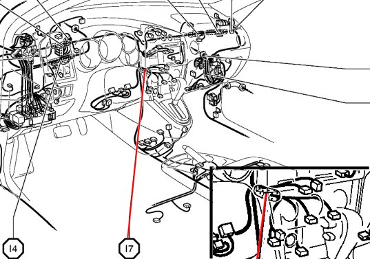

The wiring diagrams I have say that the positive and ground for all the lights in the center dash come from "splice point I7" (eye 7)
Here's a pic showing where I7 is located.
You said you bought your 08 Vibe used, so maybe a previous owner did something odd in that area.

Thanks for the replies! the wiring diagram is esp helpful as I feel it has something to do w a main power source rather than a bulb.
