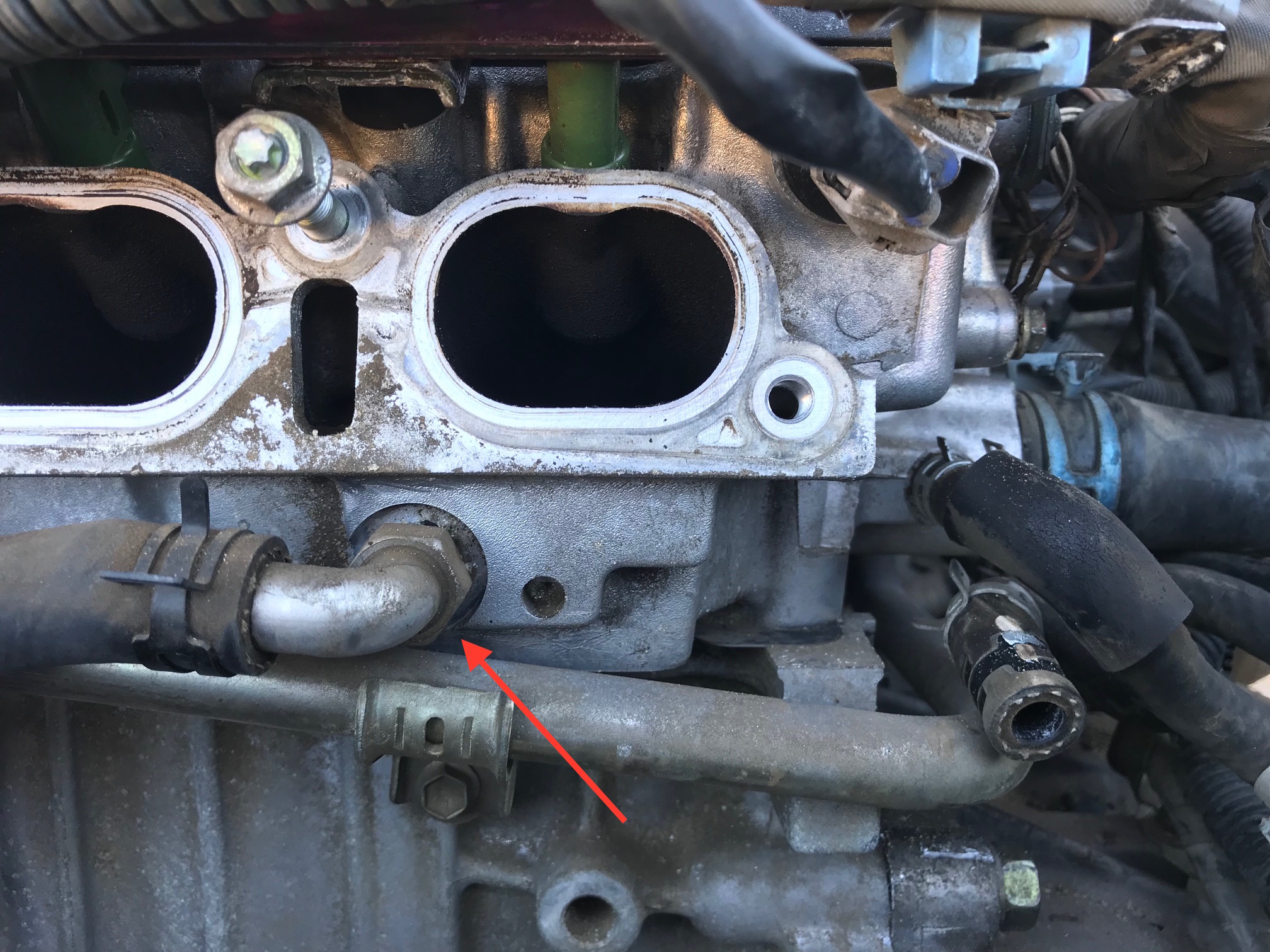

I have a 2005 Matrix that needed the engine replaced. I bought what I thought was a 1ZZ-FE engine from a reseller. When I went to install it, every thing fit perfect except one thing. Directly under the intake manifold there is, what appears to be, a cooling line. It comes out of the block, takes a 90 degree turn, goes horizontal (towards the fan) for a bit, then goes vertical down to the bottom of the engine and then heads toward the radiator. This was NOT on the original engine I removed. (I know, should have gotten the new engine model number off the block before bolting it to the transmission, but I digress) As a result, I have no where to connect this line. What do I do? If I knew what this connected to, I might be able to modify the piping and make it work. Let me know if you need a photo.

Post some pics of the engine in question, as well as the coolant line you're referring to.
It's possible this was some minor difference between model years the engine was used.

Here is a photo of where the line comes out. On my old engine it is flat steel, nothing there.
Hose on 1ZZFE.jpg (819.36 KiB) Viewed 13448 times

I'll take an inspection mirror and look under my intake manifold in a bit.
Re: 1ZZFE Extra Cooling Line?
This write up is regarding the intake manifold gasket, but shows the same location, and that coolant line is not present. https://www.toyotanation.com/threads/di ... cs.410129/
Specific Image that I am referring too...
Do you know what year/model vehicle that the engine was removed from?

hipwr wrote: ↑Tue Sep 03, 2019 6:34 am I stumbled across this when searching for an answer. Anyone have an idea if this could be it?
"The 2004 and newer Matrix and Corolla XRS models were equipped with smog pumps and have an extra hole above each exhaust port in the engine head and manifold where air is injected to achieve complete fuel burning before the exhaust stream reaches the catalyst. All 2ZZ-GE heads from 03/03 onwards carry this modification even if the vehicle does not have the air injection system."
Yes, what you have quoted is true; however, you said you have a 1ZZ so the aforementioned would not be applicable.
