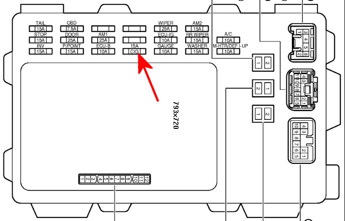

I think I’ve blown a fuse that is part of my clock and radio circuit cuz my clock and radio have died. How do I locate, remove, buy, and replace the fuse. I now have an 07 Matrix

Re: Blown fuse
If it's like one of my Vibes, it's the CIG fuse, located in the very awkwardly placed under dash fuse block. On mine, the 12V outlet under the HVAC controls was bad, and if I wasn't super careful, it would short out and take out the fuse, which also provides power to the radio in the 03-08's (don't know about 09-10) It's a 15A fuse, likely blue. I think they are called mini blade fuses
In a pinch, if you're not using it, you can borrow the INV fuse, which provides power to the 110V AC inverter. On the 03-04s, there was a second 12V outlet inside the console between the front seats, but they dropped that for the 05-08's. However, the wiring for it is still there. It got power from the P/POINT fuse, which, if that fuse is there in your 07, does nothing and can be used as a spare for the CIG fuse

Oh this is brilliant. So, a few questions. 1. Where would I find this fuse block? 2. Are you saying that I coukd replace the blown Cig fuse with either the Inv from the bottom far left column, or the ppoint from bottom second column?
Re: Blown fuse
radioarno wrote: ↑Thu Apr 10, 2025 7:25 am Oh this is brilliant. So, a few questions. 1. Where would I find this fuse block?
On the left side of the steering wheel, there is a small fold out storage bin. The fuse block is inside the dash, under that bin. The fuses are on the bottom of that fuse block, to get to them you have to stick you head under the dash and look up with the door threshold digging into your back. It's brutal. There's a black plastic cover that snaps on, hiding the fuses, has a fuse map printed on it. Don't know the history of the car, so that cover may or may not still be there.
I blew mine often enough that I left the cover off, and got pretty good at using a flashlight, a mirror, and some clamping foreceps (which I kept in the car) while kneeling next to the open driver door, but you'll probably end up having to do it the most painful way the first few times. Sorry.
radioarno wrote: ↑Thu Apr 10, 2025 7:25 am 2. Are you saying that I coud replace the blown Cig fuse with either the Inv from the bottom far left column, or the ppoint from bottom second column?
The INV fuse and the P/POINT fuse (if its there) are two of the same type and rating fuses that can be pulled and used to replace a blown CIG fuse with no impact. (other than disabling the 110V AC inverter)
However, fuses don't blow because they got old, they blow because something caused too high of a current draw, such as a short. If it is in fact the CIG fuse, then it could be that putting a good fuse in there will cause that fuse to blow also, if the original short isn't fixed. Then you'd have to figure out what the real cause is. If the fuse doesn't blow, then be extra careful when using the 12V outlet. Don't rotate anything plugged in to it while its in the outlet.
If replacing the CIG fuse gets your radio back, then it would be prudent to hit up some auto parts store or department and buy a little box of those 15A fuses, because if it was due to a failing 12V outlet, odds are you'll blow that fuse again
If its a factory radio, once you do get power back to it you'll need to set the clock, but radio should still have any radio presets you had set.

hey joatmon, I replaced that cig fuse, worked perfectly for one trip, and it blew again. Why would a fuse blow repeatedly? It's the cig fuse.
Re: Blown fuse
My guess is that there is a problem with the 12V outlet in the dash, the one next to the 110V switch and outlet.My vibes had terrible luck with them, the factory ones aren't as robust as I would have liked. That was the cause of multiple CIG fuse blows for me.
Did you use that outlet the day the second fuse blew? If so, then that's the most likely villain. If not, but you have used it in the past, it could be borderline and a bump in the road made it short out again. If it blew while you were using that 12V outlet, maybe switch to the one inside the bottom of the console between the seats. (which gets power from the PPOINT fuse)
I saw in another thread you bought your 2004 used. Does it still have the factory radio? If not, maybe there is a problem with the wiring for the replacement. If still factory, I wouldn't expect the radio to be the villain. The only common issues with those are backlight bulbs burning out, and paint wearing off the buttons.
If it is a bad 12V outlet in the dash (the one in front of the shifter), they can be replaced, pulling that trim off to get to it is not that hard, but it is also not token task
