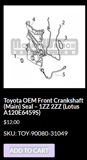

spoke to my mobile mechanic today. he remembered when we changed crank sensor o ring we didi not have a new o ring , so he put nice condition existing o ring back in... anyone know the part number . also part number for crank seal . Thanks.

from my maintenance spreadsheet:
vvt solenoid o ring # G1917-32010 (or JIS P14), crank sensor o ring is same part #!
Good luck with your oil leaks, following your saga on the TN site, too.

Post by Fletch614 »
copied this from Monkey Wrench Racing site
