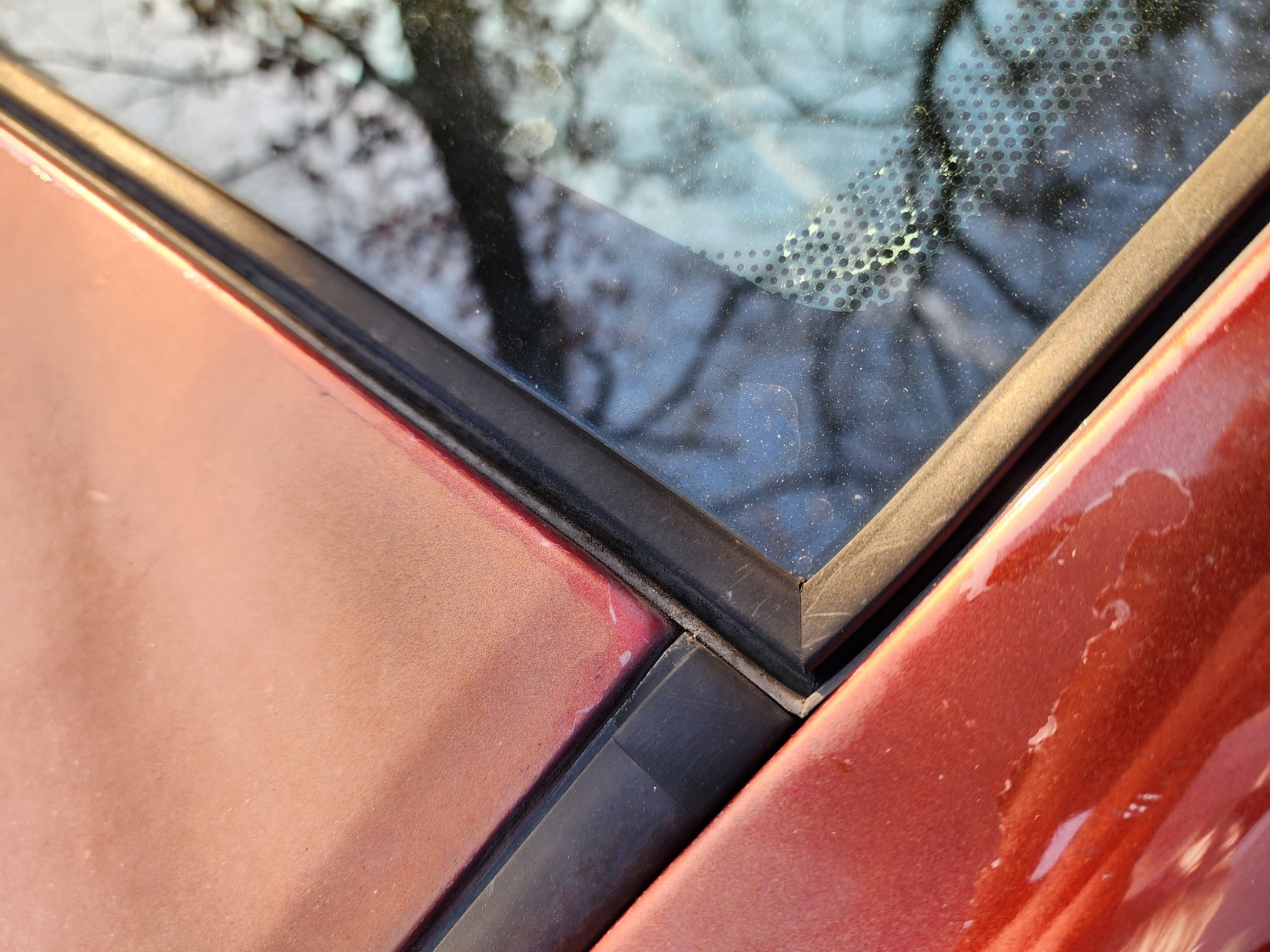

It sounds like it is the windshield moulding gap/seal. You could put some flowable silicone windshield sealant and add it between the moulding and car metal to see if the leak goes away. I attached a picture. Correct me if that is not your issue.

Good pic of the same issue that I had. Daisy ....... Please send us a good pic of your "wet spot" or drips, and if it is similar to both of ours, then it is very likely windshield related and NOT the luggage rack.

I do not have a picture of the wet spot, but it is 100% identical to the picture posted above (but on the passenger side of the car). I will closely inspect the windshield interface and will add some sort of sealant to that channel that is in the upper corner area and will report back.
Any recommendations on a "flowable" silicone sealant? The only sealants that I have used have been the thick clear silicone used to seal fish tanks and the like. I imagine I'd dispense a bead across the top channel of the windshield, and force it into the channel to (hopefully) stop the water from getting in.

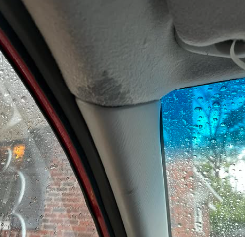

THANK YOU FOR THIS!!! Hard to believe that the windshield could wick water that far away from the entry point. My car is leaking in the exact same spot (to a lesser degree). I have owned the car for 6 months (and we LOVE this thing)- so I have no idea whether the windshield is original or not. Are there markings that I can find that will tell me if it's original or a replacement? Here's a picture of that upper corner of my car.

Daisy wrote: ↑Tue Mar 11, 2025 2:03 pm Are there markings that I can find that will tell me if it's original or a replacement?
Not sure on how to determine OEM from replacement ... BUT it almost looks like someone did repaint the edge just under the rubber trim moulding. Either that or the pigment separates as the clear coating fades off & exposes it. In any case, peel back the rubber trim and inspect what's under there. Also perform a water test too ONLY in that direct area to verify leakage.

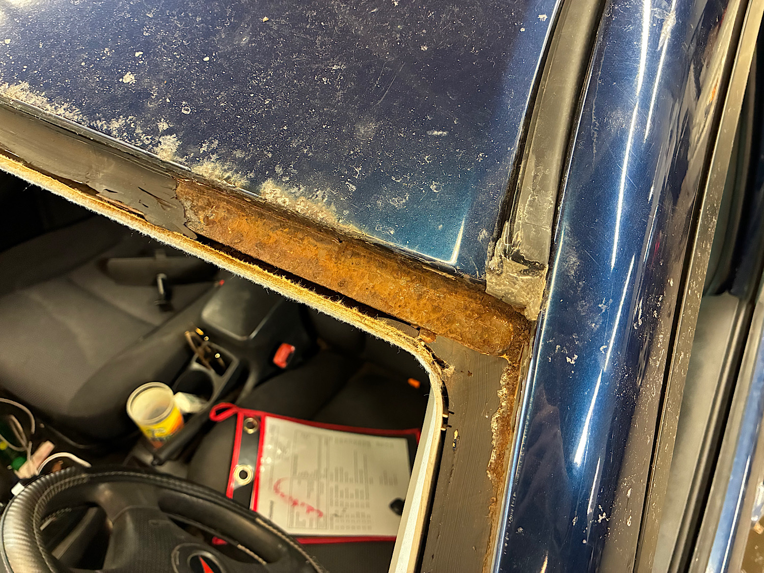

I posted elsewhere but I wanted to add to this thread for anyone else who faces this issue. I had figure out months ago my leak in my 2008 Vibe was coming from the windshield and I sealed it and it stopped. I recently had a big crack in my windshield and had to have it replaced today. the tech called me back and showed me the issue and why it had been leaking. I have attached a pic with the windshield removed so you can all see exactly what the cause of the leak is. See below! If you check/seal the sunroof and the leak doesn’t stop it’s likely the leak is coming from the windshield.
Jane
Joined: Sat Feb 14, 2026 11:54 pm
Re: Water Leak in 2004 Vibe
Post by Jane »
Thanks for posting pic, steveassault. I've got a 2005 Vibe and have not been able to figure out source of leak. Tried caulking bolts to roof rack but no luck. Seems that the problem stems from the windshield as indicated by several posts. Can you tell me what product you used to seal your leak prior to windshield replacement and where you sealed it? Thanks for responding!
