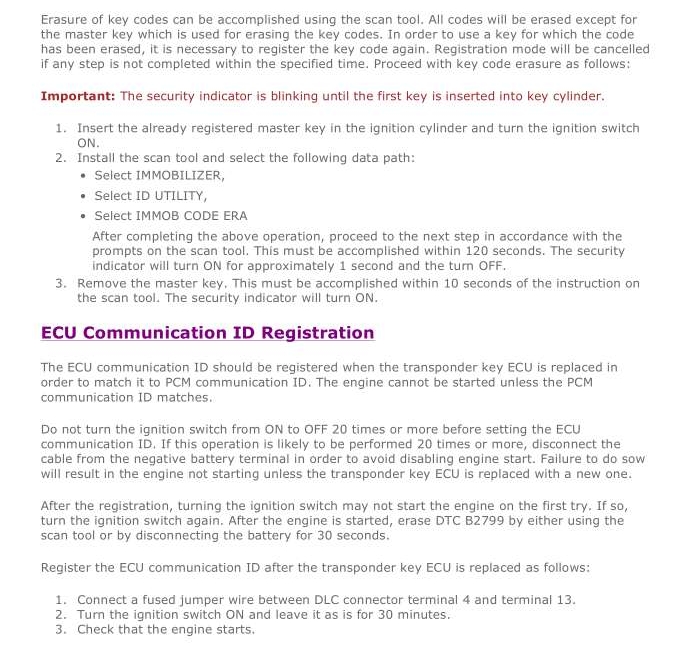

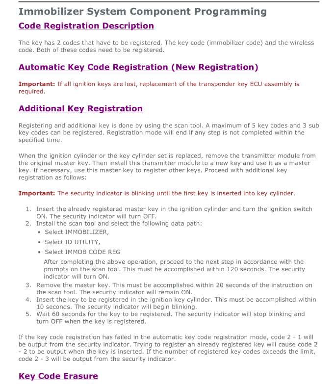

Here is info about the immobilizer system. The thing to note here is in red. If all ignition keys are lost, replacement of the transponder key ECU assembly is required. You need to check to see if GM even sales the transponders anymore. If they do then hold on to your wallet as andrewclaus has said. The car will need to be taken/towed to the dealer so the part can be replaced and programed.
The door locks are a different item and programming. The programming for the immobilizer is done with factory programmer and not all GM dealers will have the proper programming updates to do the Vibe. You are going to need to call around. If you look around where the key is inserted into the steering column and see that the outer ring around where the key goes in is made of metal, then the car does not have the key transponder. If the outer ring is plastic, then it most likely has the key transponder and immobilizer system.
