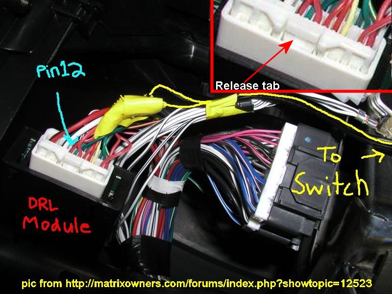

*%$##* Now over 3hs, 2 attempts, skinned knuckles & arms.
To simply cut #12 wire to disable DRL. Cannot remove / pry headlight relay plug-block from relay. I even unscrewed relay from mounting point. More access but no luck.
Evidently, there are clips that hold the plug in. Where are they?
Any clues how to dislodge the plug from the block???!!
I'm giving up round-2.

Re: Headlight Relay DRL
Vibraphone wrote: Sun Oct 13, 2024 1:40 pm
I think you are talking about the DRL module.
At some point I saved off the picture below, and I have edited it to include a zoomed in portion of the connector with a red arrow pointing to the tab that you have to push in (towards the wires) to get the connector to release. Can sometimes be a pain to push in, while pulling the connector out of the module. I have sometimes needed to use needlenose on some connectors
matrixowners.com used to be a toyota matrix forum, but it disappeared from the internet some years ago, so the link in the pic is dead, unless perhaps you try the internet archive wayback machine.

Post by Vibraphone »
Thank you!!!
I was prysing the DRL plug outward. Pushing the plug inward twd the plug 'block' and out it came.
