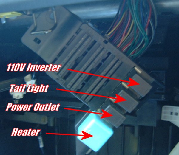

If they did, and the blower motor is fine, then it could be a connection issue. Maybe the connector on the blower motor itself is not fully engaged, and makes and breaks contact with bumps. Another possibility is that for some reason, the Heater relay has worked itself partially out of its socket. It is in a hidden panel above the glove box There's a picture of it with the panel unscrewed and pulled down at download/file.php?id=33 ) You could pull the glove box, and reach up and around to press the relays down into their sockets. Don't remember folks here having that issue with the Heater relay, but some have had that happen with the Tail relay in the same block.
