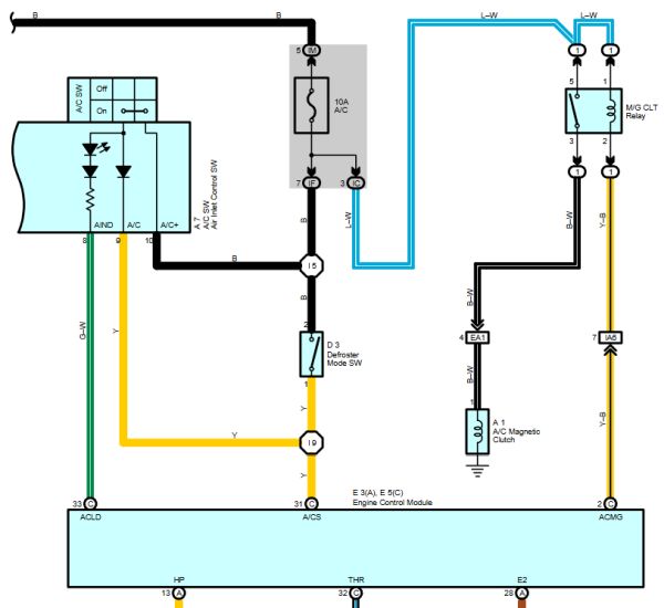

Here is a bit of the 04 matrix AC wiring diagram, shows what the AC fuse feeds. If there is a short blowing the AC fuse, it would be somewhere in there, although I can't offer advice on how to isolate it
Thank you so much for the help! Do you think just buying a new compressor (with clutch) would be the easiest route? I'm terrible at tracking down electrical shorts?
I'll take the schematic you sent and try my best to track things down and see if I can find the short. Is it common to have a short in compressor clutch? Basically the fuse used to run for a few minutes then pop but lately it pops pretty quickly... I don't even know if that helps at all?
