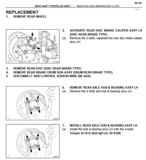

I got new rear backing plates to hopefully solve my parking brake issues. (The existing ones are rusted and flex when the parking brake is set.)
But to replace the plates, I'll have to remove the hubs. How do I go about doing that?

the 03 matrix manual procedure is attached, the first part of it is:
x040001.pdf
(70.48 KiB) Downloaded 410 times

Thanks for the manual pages. The sketch makes it look so spacious and uncluttered to reach those bolts...
