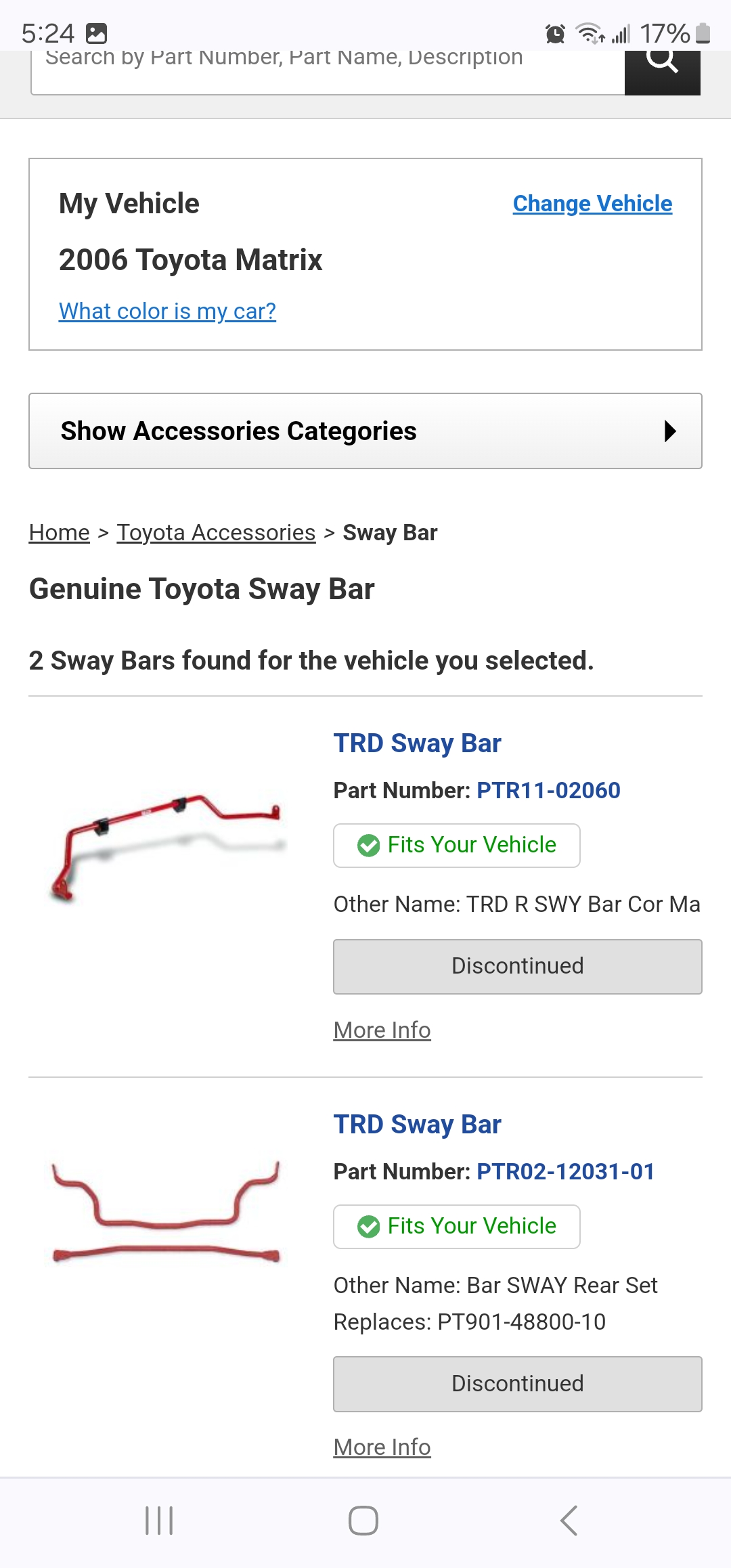

Hi the site isn't what isnused to be. Many of the users have moved into different cars and no longer post here. I also no longer post here frequently but used to post quite a bit back around 2009.
Anyway, concerning the TRD parts for your car, these are for the most part no longer available for sale anywhere. You might get lucky and find some parts listed on ebay or elsewhere. I suspect most the these TRD sway bars ended up in a scrap heap along with the cars, most of which may have been scrapped. If not they may have been shipped to central America. A lot of old toyotas tend to get shipped there.
There are a few other aftermarket type subframe stiffening parts I've seen on ebay that are suppsed to fit second generation vibes. I'm not at all familiar with how well they fit or work though.
