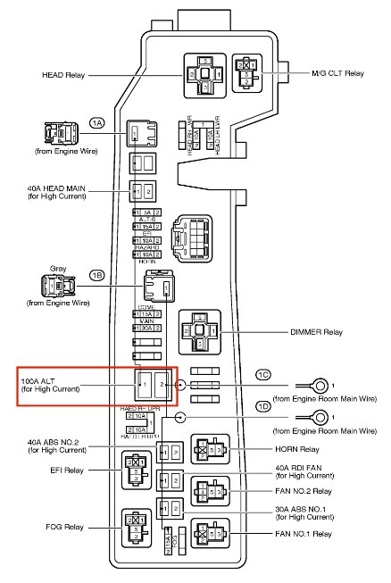

I attached a PDF of the primary power distribution schematic, its for an 03 matrix but it matches your 03 Vibe
Power comes from the battery, gets to the horn and hazard fuses since those things still work. I'd look at the 100A Main fuse. Its bolted in from underneath, but you might be able to see through a clear plastic cover. Also, try pulling the fuses that the 100A Main fuse directly feeds, and see if you get 12V on one side of any of those fuses. If you do then the Main fuse might be ok
Not saying this happened to your Vibe, but folks here have reported blowing the 100A fuse by trying to jump start a Vibe unfortunately with the cables crossed. In some of those cases, some other fuses got popped as well. I've never had to replace one, but reports are that fun is not involved

Thanks, but exactly where is this 100 amp fuse? Looking at the positive battery cable it goes directly to the fuse box on my 035

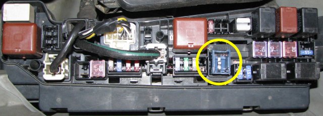

my bad, I said Main fuse, but its the ALT fuse in the underhood fuse block
edit - this video offers some insight into replacement
https://www.youtube.com/watch?v=5rKZi4e4lPQ

Yep, that's popped! Thanks!
What's the trick for pulling it out?!? Oh, never mind, I see it's bolted from below.

Tardy update: It was that 100A fuse, and it was a pita to get that bolt under it off and back on.
