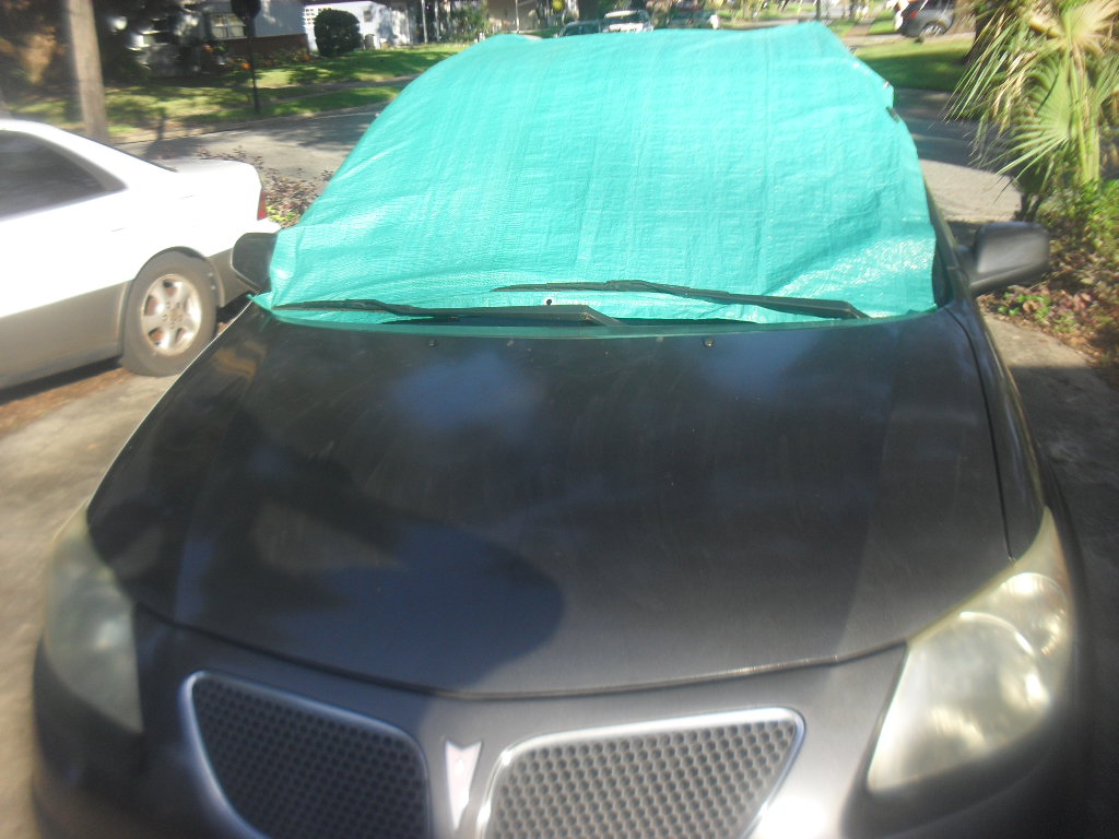

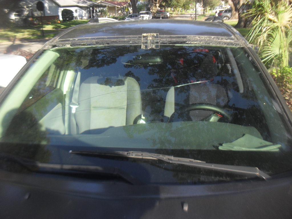

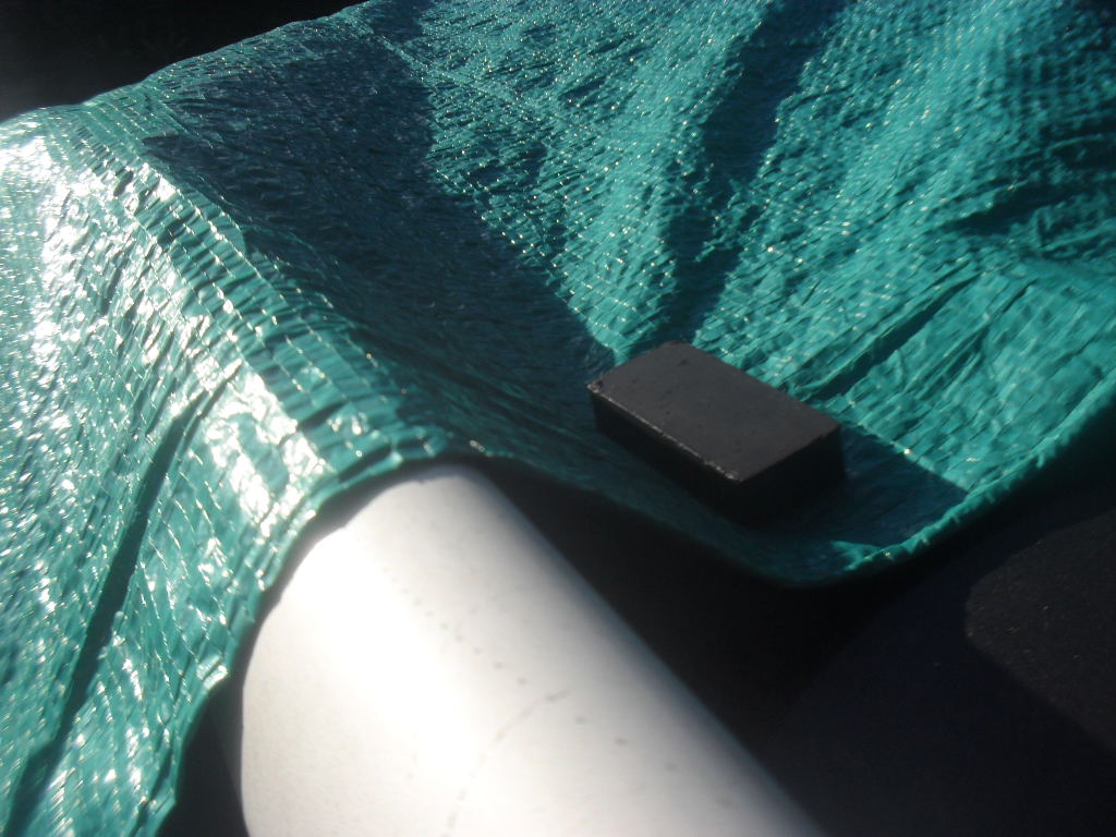

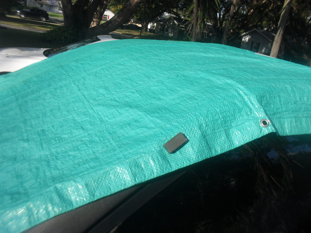

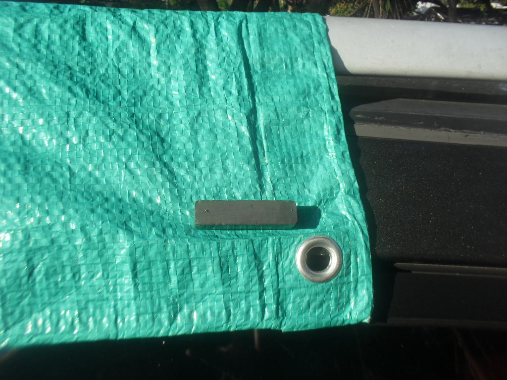

tpollauf 021122 Photos of windshield top, and tarp
Dear tpollauf, here are Photos of windshield top, and tarp. Since the Gorilla Tape didn't work, I removed it. I still have a lot of clean up to do from that. But at least the tarp stopped the leaking. Jim

Wow ... you went to extremes BUT at least you temporarily controlled the leaking! Mine is getting worse by the week. Today, we got the remnants of that Hurricane along the lakeshores of Lake Erie and it rained all day. The Vibe's interior got even wetter since the last rain. Passenger seat is totally soaked & the headliner is getting worse. I'm going to have to do something sooner than later. Was hoping to put this off till December. Not sure now :?

The tarp is not the ideal solution, but it works and is inexpensive. I put the tarp on when there is rain forecast, and I can't park the car in my carport. I have not had the leak in a year because of the tarp.
Before I discovered the tarp solution, I tried everything, but was unable to pinpoint the leak. So the tarp was the simplest solution for me.
Let me know what happens with your leak, and if you discover the exact source. Jim

Dear Tim, nice photos. I am still using the tarp, as shown in the photos, but mostly parking the Vibe in the Carport, while both my Lexus' (98 and 01) are out in the rain. It's a shame that such a well engineered vehicle should have this problem. I haven't heard if the twin, the Toyota Matrix, has the problem. Jim

I wish you luck. I tried everything I could think of, except a $2000 repair, to stop the leak.
I finally found that putting a cheap green 6' x 9' tarp over the windshield and half the roof, with magnets, stopped the leak when the car is parked.
Strangely, it doesn't leak when you are driving the car. See my photos a few messages above. Let's talk when you can figure out how to give me your phone number without telling the world. JC
