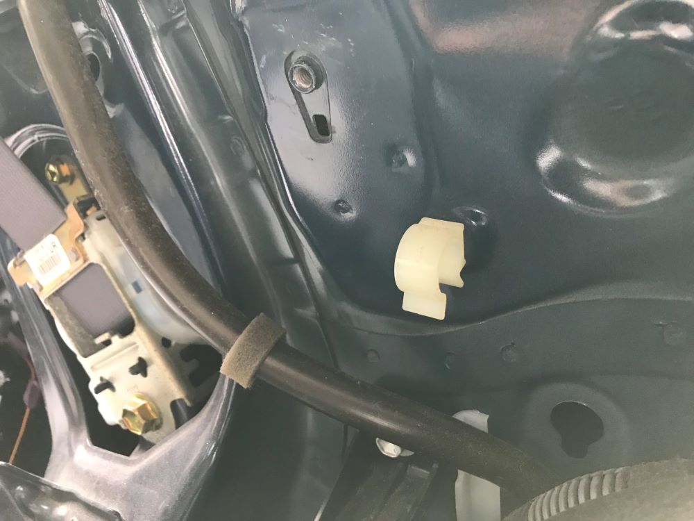

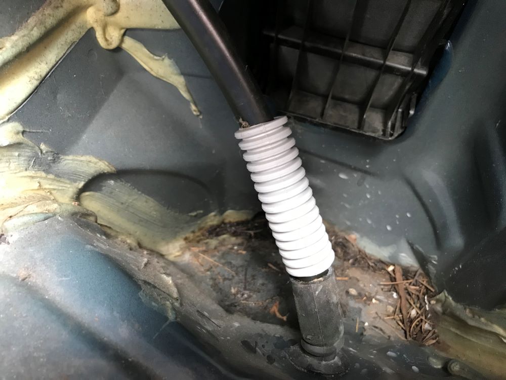

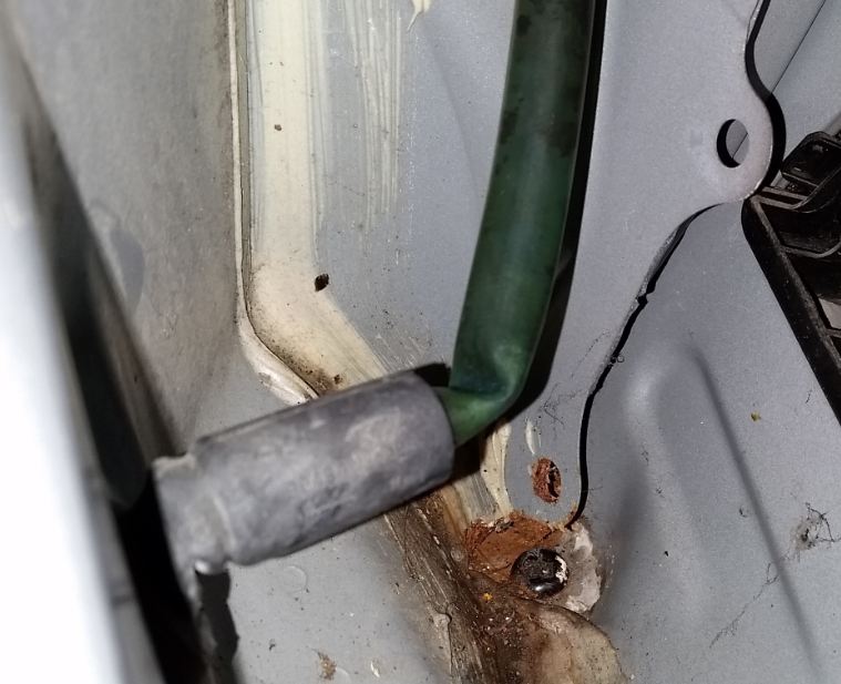

I had the wet rear passenger floor issue but fixed my roof drain (the issue) a while back. It is common the drain hose kinks near the passenger rear wheel inside the car. Remove the rear panel in the hatch area and see if your hose has a kink Pic 1. If so, straighten it out and use something to keep it round - I used a cut piece of dishwasher drain line I just replaced, perfect fit Pic 2. The whole problem in my opinion is they installed the hose support clamp upside down, and over time the hose pops out and gets the kink, so turn the clamp 180 degrees so it supports the hose Pic 3.
