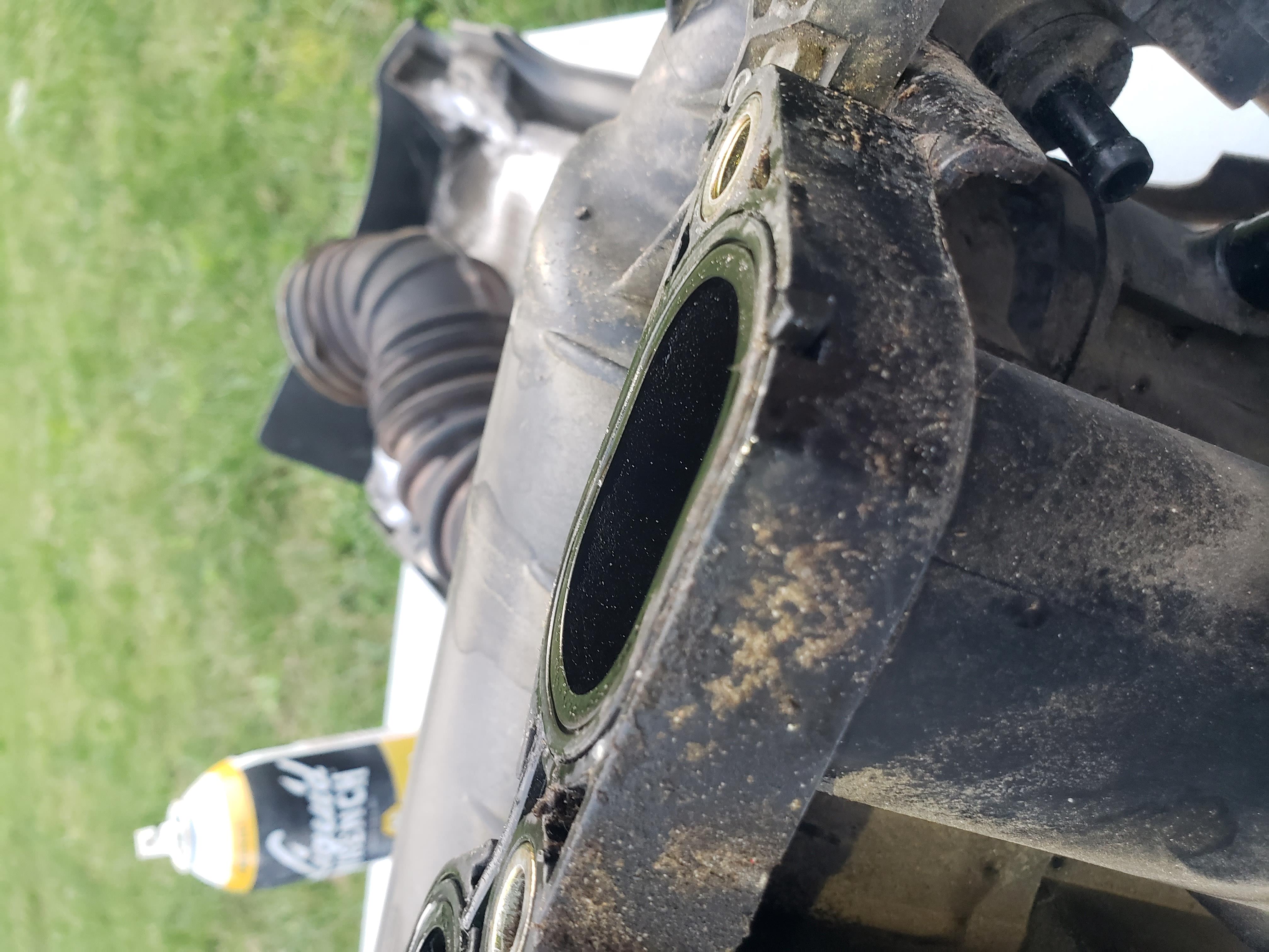

1. I replaced all three gaskets for the throttle body (Toyota Part 22271-0D030), IACV (22215-7A680), and air intake manifold (17171-22060). The old gaskets were definitely old and flattened (see picture). Toyota updated the throttle body and manifold gaskets and they are definitely "thicker" than the originals and now form a proper seal.

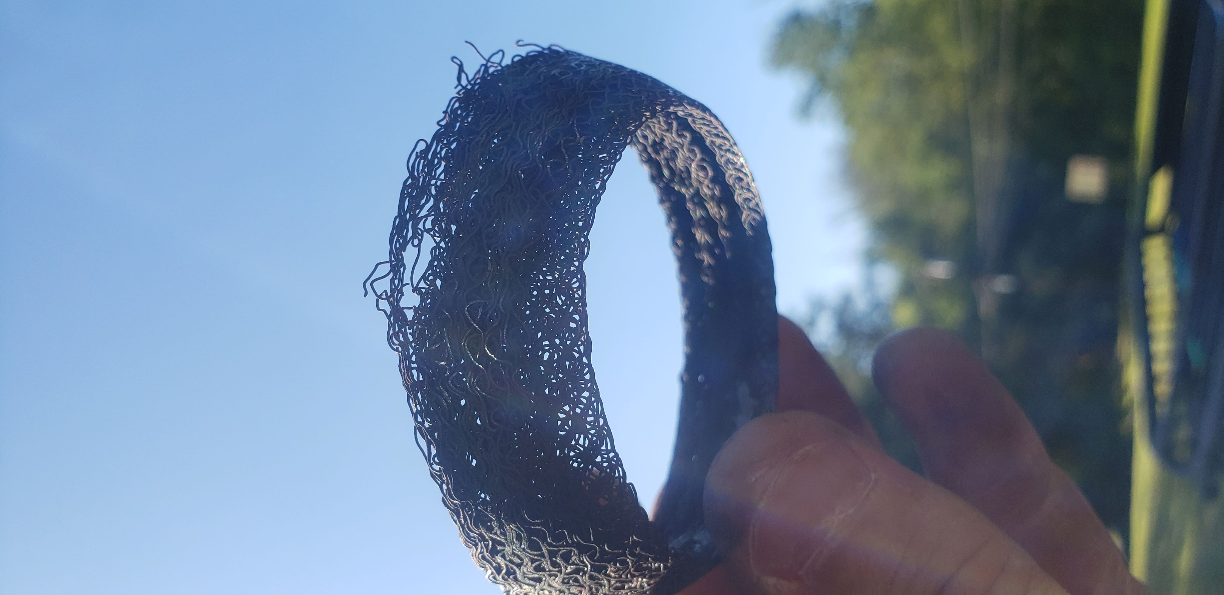

2. I replaced the 1st and 2nd exhaust flange gasket/spring bolts. Mine were original and basically crumbling/non-existent (see picture of each). I replaced: flange1 gasket (17451-0D060), flange2 gasket (17451-0D070), and I used the same bolts and springs for both (90109-A0013 and 90501-A0006). FYI removing the front O2 sensor and manifold heat shield allows you to easily clean the exhaust bolt threads with a wire brush and soak in penetrant. If you need to use a replacement nut for any of these bolts, the size is M10x1.25.

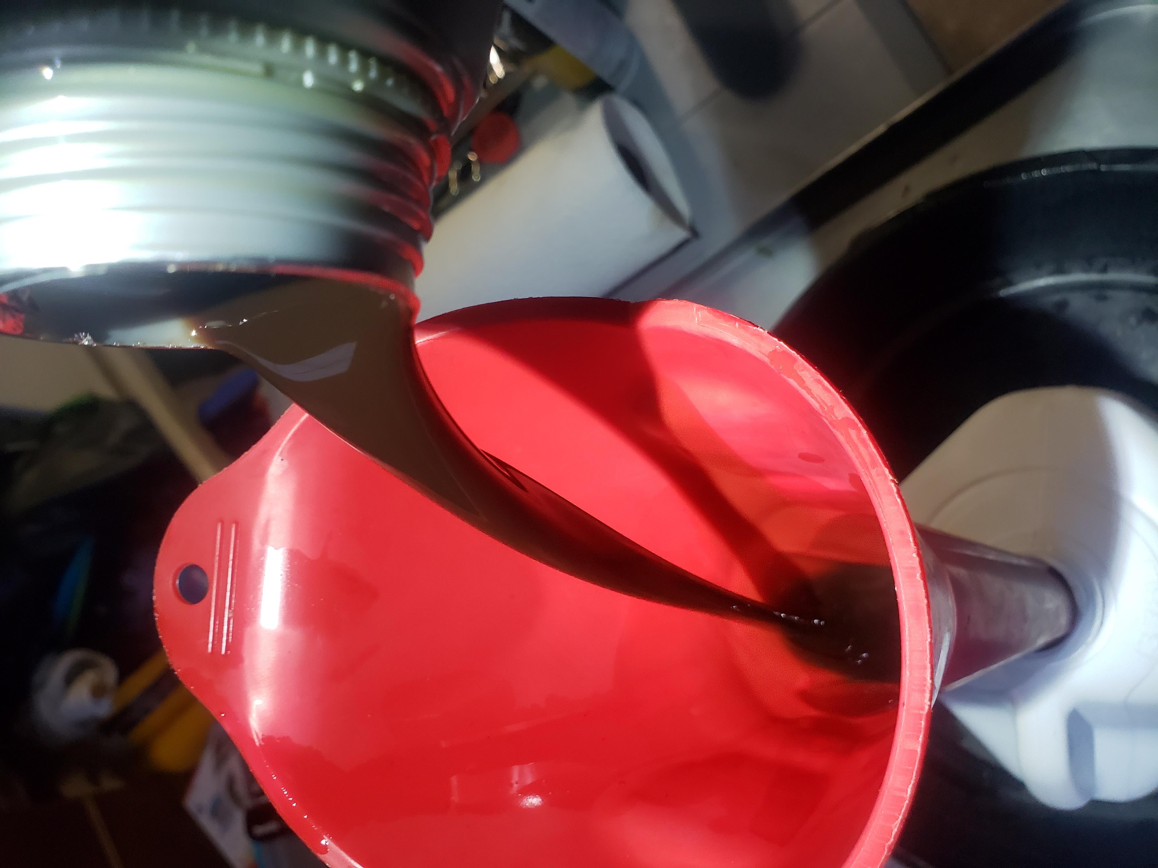

3. I now suspect a transmission issue is causing the poor performance. My fluid was extremely brown and looked like motor oil (see picture). My transmission was replaced 40k miles ago and was filled with Castrol transmax. I now flushed it with Toyota T-IV and might have to do a second flush since I only got 3.5Q out of 7Q total on the first drain/refill. No performance improvement after first flush though. I recently started to notice that sometimes the transmission has a hard shift from park to reverse/drive, although it doesn't happen all the time. Restarting the car seems to make the problem disappear until I restart it. I suspect a solenoid or sensor is acting up. No OBD codes. Not sure if I can address this one myself - I may need to take to a mechanic to diagnose. I'll follow up on any leads here and will report back if I end up having a mechanic diagnose it.
