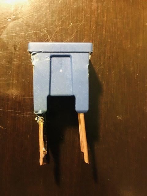

Last June 2023 my 2003 Vibe had a NO CRANK NO START power windows down! So I went under hood checked fuses replaced all the mini fuses, 30s 40s and low and behold seen that 100a and snatched it out! Found out after the fact two bolts holds it in! Went on YouTube found out how to really replace/fix it and low and behold as I tightened the smallest bolt I tightened it too much and the head broke offff! The car still wouldn’t crank/start!

Now I’m thinking that first STrelay from advance auto blew my 100a fuse!!! Uggggh Remember that dang small bolt I broke off!?

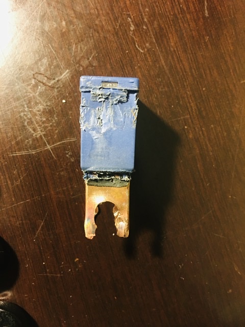

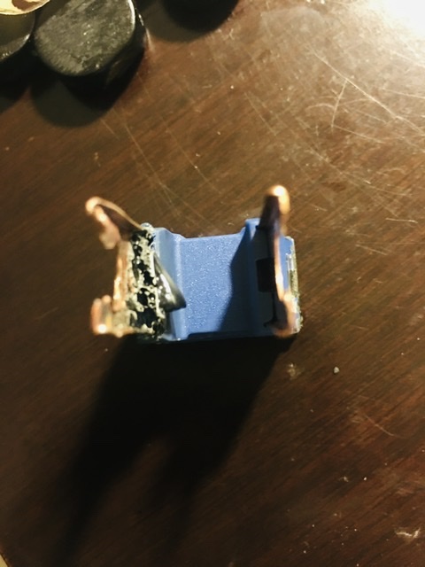

Now I have to go back to remove it and it was a very difficult task but I did get it out and it was melted on one side in the fuse box.”

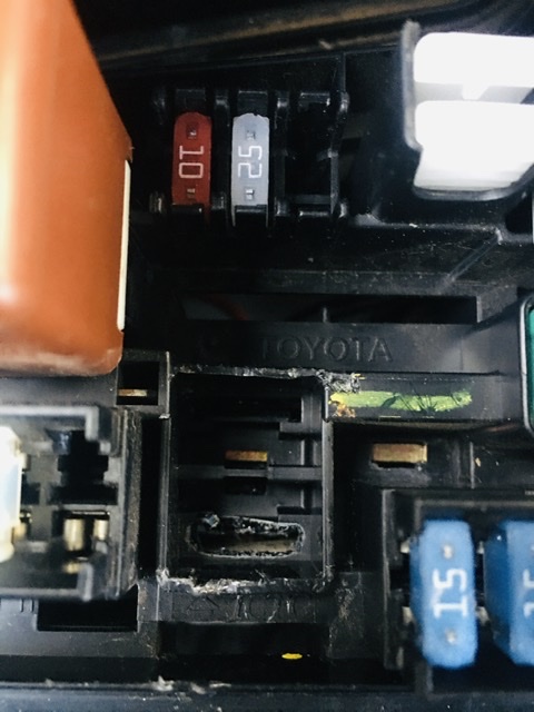

INSIDE FUSE BOX
INSIDE FUSE BOX
100A fuse
100A fuse
100A fuse
100A fuse
100A
100A

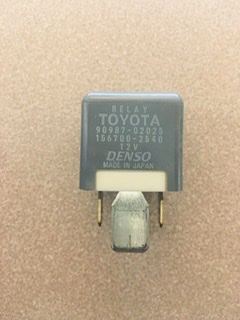

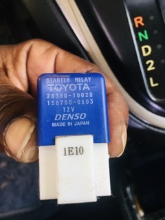

ORIGINAL STARTER RELAY SWITCH
Advance Auto version
Don’t buy this one
Don’t buy this one

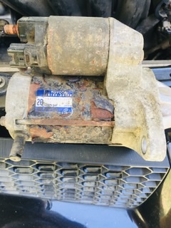

OLD STARTER SOLENOID LOOKS LIKE ORIGINAL LOOKING STARTER

I literally just traveled this path (viewtopic.php?t=48532). I didn't realize the bolts either, and apparently the person before me didn't either and left one out which bit me in the glute. The harder side is an M6; you want to make sure the ring terminal is connected to the bar, it's not just the fuse leg. The easier side is an M5. I replaced them both with Philips bolts cause it's a pain to align them and start them as hex bolts. While you have the battery out, and most of the air box out of the way, I recommend cleaning up the ground points. You'll have to read my journey to see if anything else helps you out.

blitzjon thanks for the info! I went back with the same bolts and made sure I hooked the ring.
if I ever have to go back in there I’ll be sure to use bolts that’s easier! I went to PULLAPART and picked up the 5m bolt and starter relays switch and 100A fuse. I put everything back together and my power windows still not working but the door lock button and key fob works...I replaced the driver door switch with a new one while the car was down. Do you have a clue what it could be?

I had to drill out the first 5mm bolt, do a clean out, and replace with a 100a I grabbed from junkyard and definitely made sure not to over tighten both bolts!!

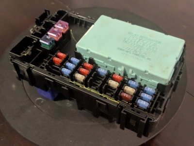

My Vibe is a base model GT without all the powered options. I'm actually glad, less things to worry about when my daughter gets the car. I was scratching my head when I looked for the Integration Relay only to find out mine doesn't have one. Maybe it's an issue for you? 🤷‍♂️
Posts: 10265
Re: ELECTRICAL 100A fuse box problem
bLITzJoN wrote: ↑Wed Aug 23, 2023 4:46 am My Vibe is a base model GT without all the powered options. I'm actually glad, less things to worry about when my daughter gets the car. I was scratching my head when I looked for the Integration Relay only to find out mine doesn't have one. Maybe it's an issue for you? 🤷‍♂️
I'd bet your car has one, although I'm not sure what purpose it has without power locks. It's a box on the under dash fuse block, in this picture it's the big pale blue thing, although I've seen other pics where its been a different pale color
