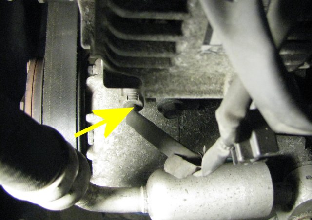

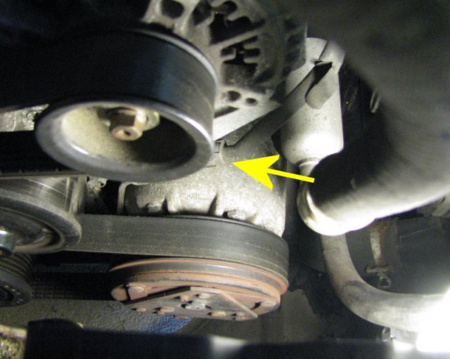

There is a wire that runs to the AC compressor, as shown in the attached images from a 2003 Vibe, should be the same for 03-08's, don't know what year you have. Matrixes are slightly different
I think the test step you are asking about is to disconnect that wire from the compressor, and with the engine running and the AC turned on, use a multimeter to check the voltage between that cable end connector (only has one pin) and ground, either the engine block or the battery negative terminal. If you read nothing, then there could be a problem with the fuse or relay or something else not allowing the 12V to get to the compressor to activate the clutch. If you read 12V from the connector to ground (11, 12,13,14 volts, somewhere in that range) then the voltage is getting to the clutch, and assuming you are doing this because the clutch doesn't activate, then you probably have a bad clutch. ( but standard caveat, I don't guarantee anything)

joatmon wrote: ↑Thu Apr 27, 2023 7:00 am Welcome to genvibe!
Brandman wrote: ↑Wed Apr 26, 2023 1:53 pm I only see one wire /connector and that is the one that is connected to the alternator. Is that what you used? And how did you do it? Use multimeter or connect the wire to the battery?
Thank you for responding after all this time! That information really helps. I will check it and find out soon.
