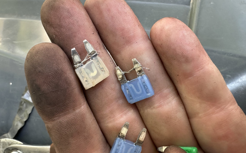

I picked up (daughter says, rescued) an '03 GT Manual for my daughter's first car for a fair price. But as issues keep cropping up, it's turning out to not be a good deal. As I was driving it to the BMV for plates, I lost all power to the cluster, no turn signals (only hazards and lights work), no climate controls and dashlights. The car is driveable, and while I had my truck in the shop, I've been driving it. Of course, I metered the fuses. Figured I would be fine until the weekend when I had more time. Well, it's the weekend, and I actually didn't make it. The car died (actually, I killed it in drive-thru, do'h, been awhile since I've driven a stick), and it was completely dead - battery drained. Fortunately, clutch-popped back to running again. Now, I removed, dremel wire brush, electrical contact cleaner, etc.., the ground points after giving the battery a day to charge. Car is starting again and driveable (maybe until the battery dies again. 🤔) Now for the (removed)'d off parts. I rechecked all the fuses by pulling them out (hey, maybe some corrosion in the contact since I used the test points on top of the fuse the first time), and how be damn, most of the fuses were jumpered.

First off, welcome to genvibe
secondly, what kind of idiot wraps wire around fuses?
There was another thread here today with similar symptoms. With all those things not working, it could be the 100A ALT fuse in the under hood fuse block. Its bolted in, don't know what level of disassembly is needed to replace it. I attached a power source wiring diagram from an 03 matrix, should be nearly if not completely identical to your Vibe. If you can't tell from looking at the 100A ALT fuse, you could pull one of the fuses in the under dash fuse block, such as stop, ppoint, inv, tail, etc, and use a meter to check to see if you have 12V on either side of the fuse receptacle. Since those fuses get power directly from the ALT fuse, you get 12V on one side or the other if the ALT fuse is good, even with the no key in ignition.

Re: 2003 GT Cabin Power Loss
Wow. Welcome to GenVibe and thanks for sharing this nightmare with us. That's a first that I've ever seen and pretty disgusting to say the least :o You're lucky that the cars wiring hasn't melted or caught fire yet with those fuses being jumped. Hopefully someone GAVE you this poor Vibe as it sounds like it needs a lot of TLC. Definitely get it up & running as these early Vibe GT's are becoming rare and when running great, are a fun reliable source of transportation :D

bLITzJoN wrote: ↑Sun Aug 06, 2023 5:26 pm I found out the hard way the 100A was bolted in. It was fine until I tried to take it out. Do'h! 🤦‍♂️ I ordered all new mini fuses off Amazon and will replace the big boy from the local auto parts store when they come in.
Make sure each fuse block has the right fuse! Don't trust what is in there now.
Anyone who would jumper fuses like that would also happily put the wrong ones in, also.

Post by bLITzJoN »
Oh, for sure, you can see others in my hand. I purchased a kit and am pulling all the mini fuses out and replacing them according to the manual with no regard for what is in there for both under the hood and dash. My replacement gauge cluster arrived, so I will likely tear into that as well, starting today, hopefully.
