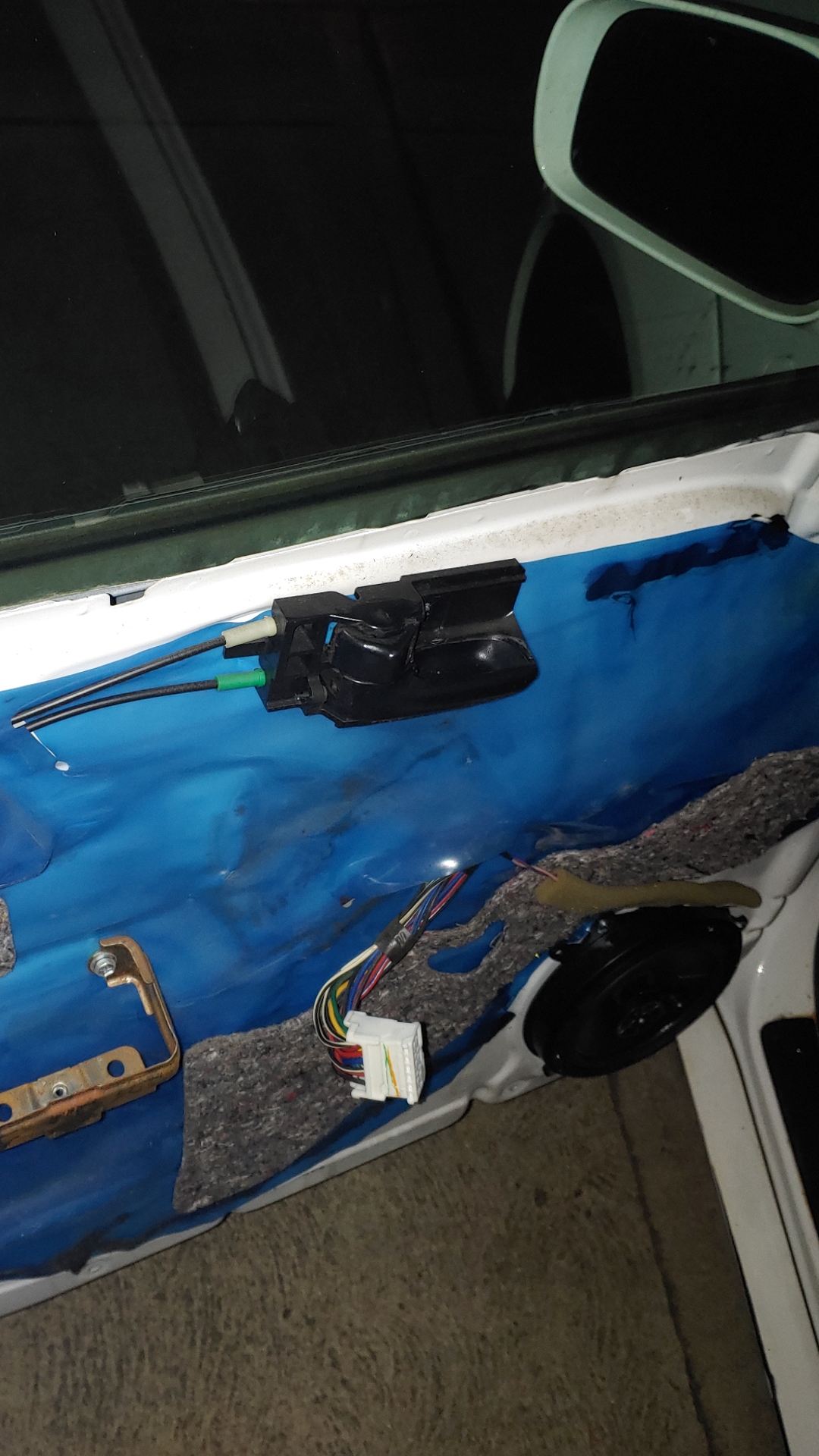

Hey, just decided to swap out my speakers in my '05 Vibe. I went through Crutchfield's guide, and got most of the way through but I can't seem to get the door panel back on. Is there a trick to slide it into place?
I looked at Derf's youtube video, and he does this weird slide thing to remove the panel: https://www.youtube.com/watch?v=oOGgu6NbOnA 4:00
vibe door panel.jpg (991.96 KiB) Viewed 16612 times

I've had the panel off of my 04 dozens of times and there's no "slide" that I recall. Just connect the electrical plug and hook the top over the door and snap it back in place. I'm not sure if there's a way to slide it so that all the panel clips slide out of their mounts? I just pop them out and then pop them back in.

You might check the weatherstrip for the window on the edge of the door panel. Sometimes for me it's worked its way loose and gets in the way when trying to hang the door panel back on.

I'll give an update on this, so it looks like there might have been some damage to the drivers side door, or it has been opened a lot. I did finally get it on, but the passengers side went back on way easier.

I've always found that the front edge corner up by the mirror is the trickiest part to get seated when installing the door cards. I usually angle the back higher, get the front seated first, then it all kinda wiggles and settles into place nicely. Good luck!
