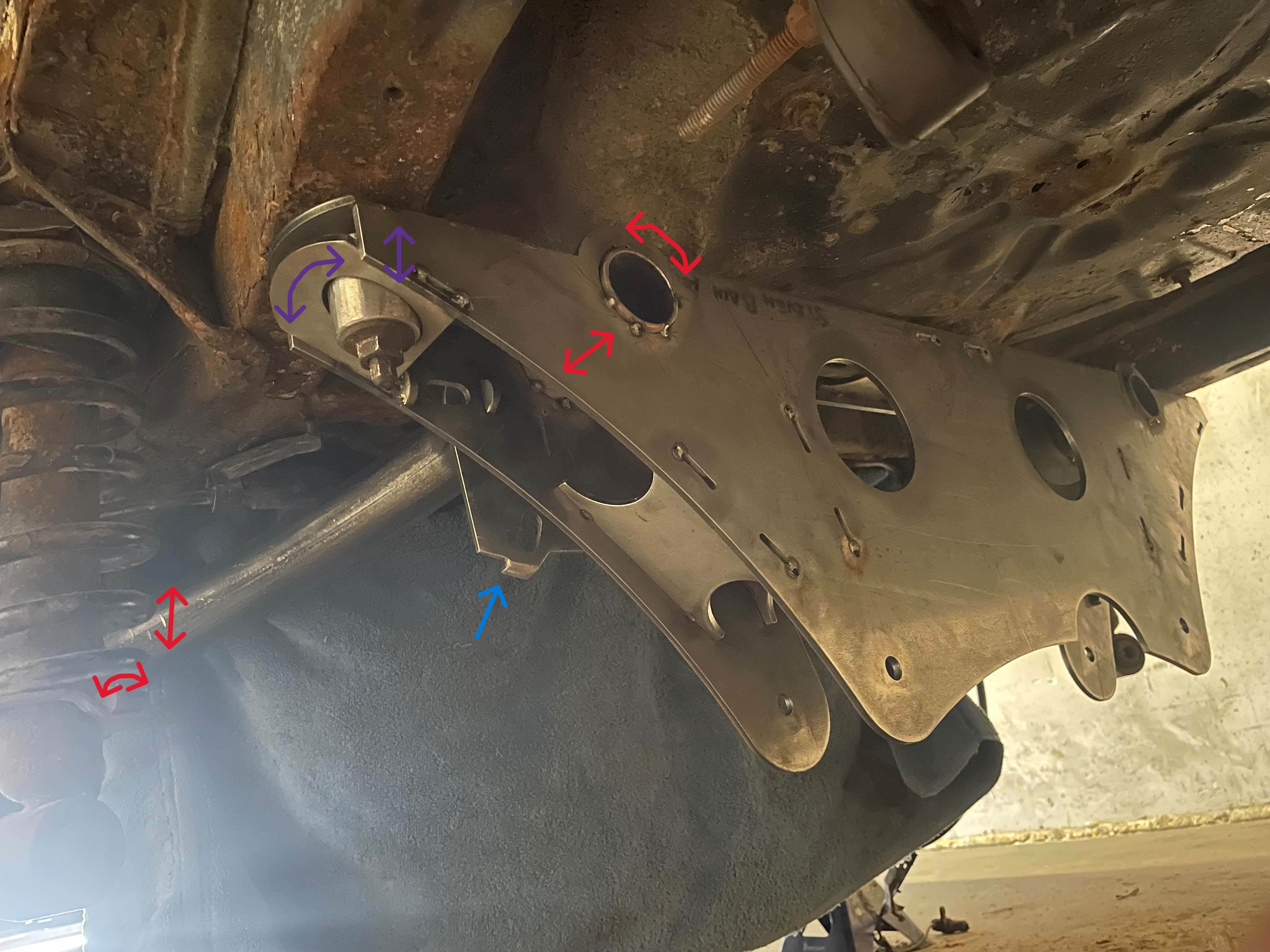

Now, the situation certainly seems dire. I'm sure many a Vibe and Matrix have died for less.
...But "design an automotive suspension component" was on my 2023 vision board, so I decided to do something silly.
While I had my old one out, I took some measurements and whipped up a little something on the computer:
*ahem*
Stock Front Corner.png (254.12 KiB) Viewed 29908 times
Stock Side.png (159.22 KiB) Viewed 29908 times
Stock Rear.png (128.09 KiB) Viewed 29908 times
Stock Upper Rear.png (222.56 KiB) Viewed 29908 times
Stock Overhead.png (133.42 KiB) Viewed 29908 times
My design criteria:
-No specialized skills or equipment beyond what a hobby welder might have access to (welder, grinder, drill, hole saw, marker)
-$500 material cost
-Mostly laser cut parts, all of one thickness, that can easily be ordered online
-Constant radius tubing bends (meaning that they can be reproduced with a Princess Auto/Harbor Freight tubing roller)
-Simple "puzzle piece" assembly requiring minimal measurement (note the tabs and slots where pieces join)
-Easy, flat welds wherever possible
-Lots of room for adjustment when installing onto the vehicle (tube bends are tricky)
-Suitable for a good old-fashioned build thread
Ideally, this is a solution (or at least an inspiration) not just for me but for the AWD Vibe/Matrix community... (but, you know, don't try this at home, liability, etc.)
So stick around while I build one of these and test it out!

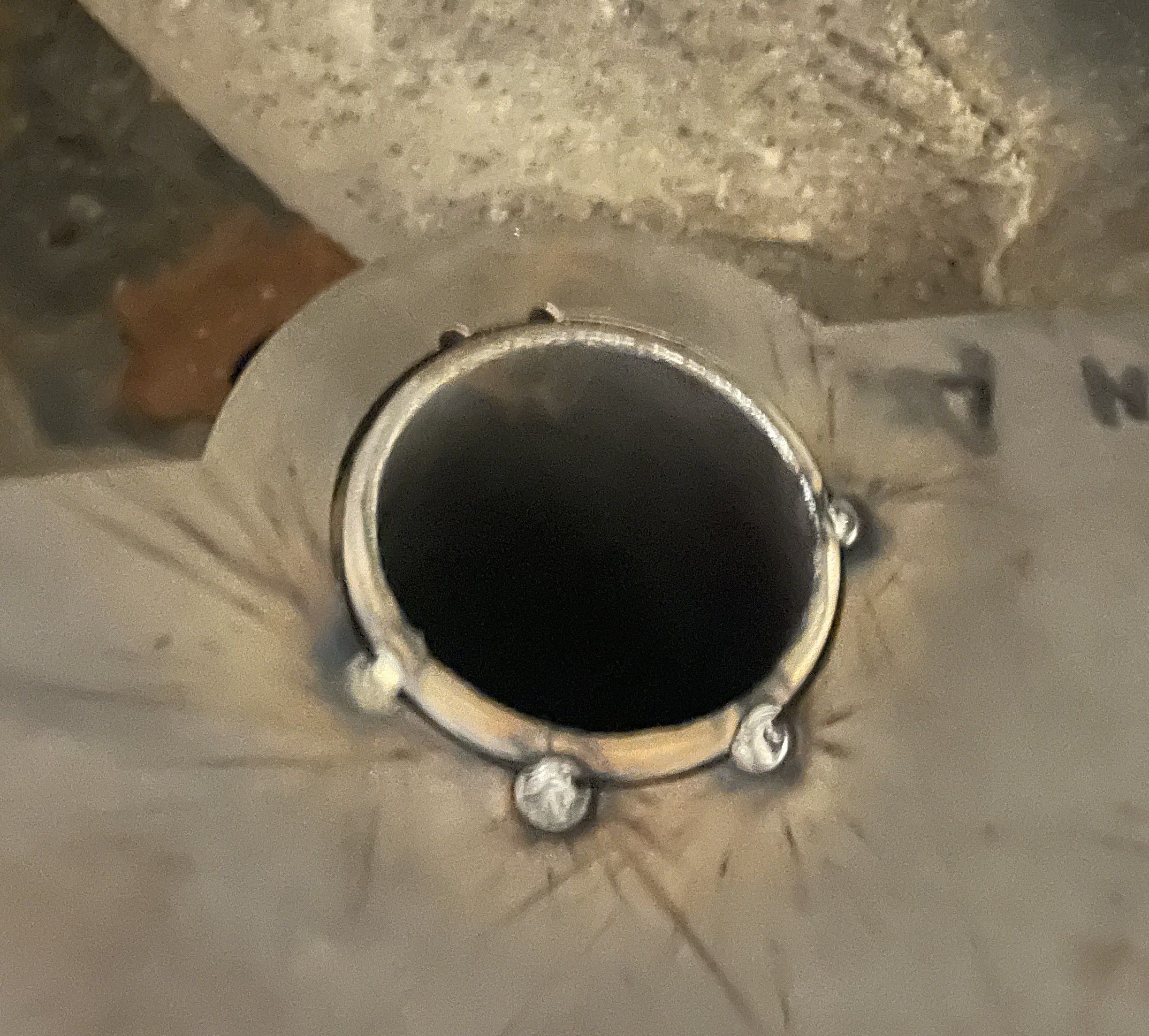

Bolt Sleeves:
To make the sleeves that the bolts pass through to mount the subframe to the car, we need our laser cut bolt sleeve caps and some 1.5" O.D. round tube. I paid $14 at Metal Supermarket for the four pieces pictured, precut to 3", which was longer than I needed. I kept them full length for testing and shortened them later.
The dimensions you need to cut them to are: 1-7/8" for the rear sleeves (making 2-1/4" with the caps welded on) and 2-1/4" for the front sleeves (making 2-5/8" with the caps welded on).
Once you've cut them to length, bevel the edges
Line the holes up--I aligned the nub on the caps with the seam of the tube, as shown
Then weld them together and grind the welds smooth
You will likely have to grind the entire surface as shown to get the appropriate fit since the tube won't be exactly round, etc. Expect some trial and error here.

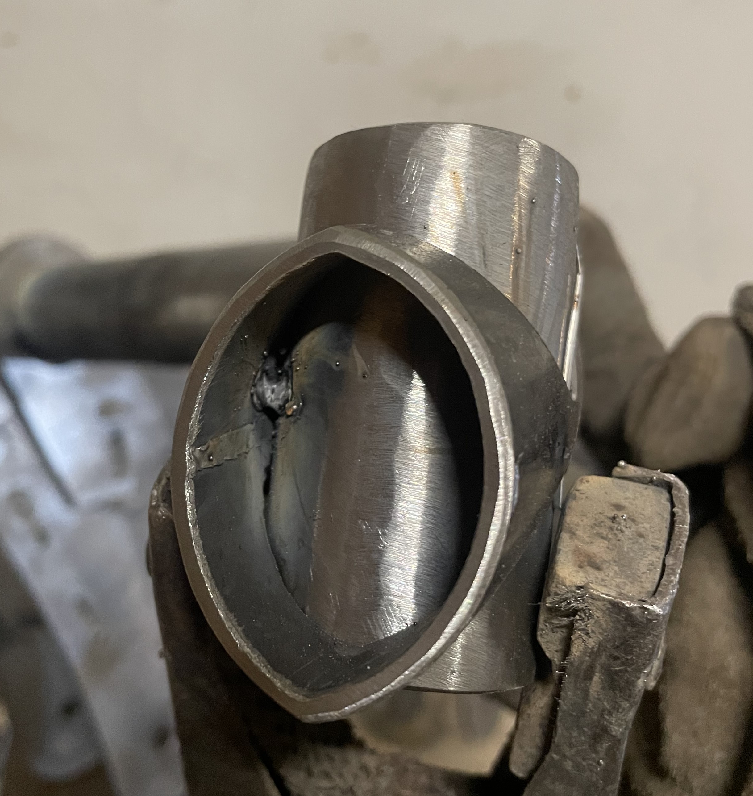

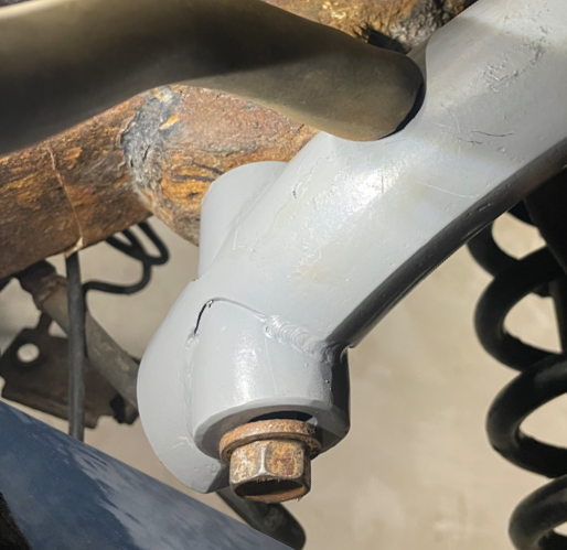

Once you've finished drilling out the arms, install the bolt sleeve into the arms. This should be a friction fit, but don't worry if it's a little loose.
Next, slide the upper control arm ears over the ends and reinstall the arms into the subframe as we did earlier.
IMPORTANT: DO NOT FORGET THE UPPER CONTROL ARM EARS. YOU CANNOT INSTALL THEM LATER.
The ears are just going to hang loose for now, but they need to be on the tube before we tack it in place.
Double check that you've got them oriented correctly and on the correct side, since they are side-specific.

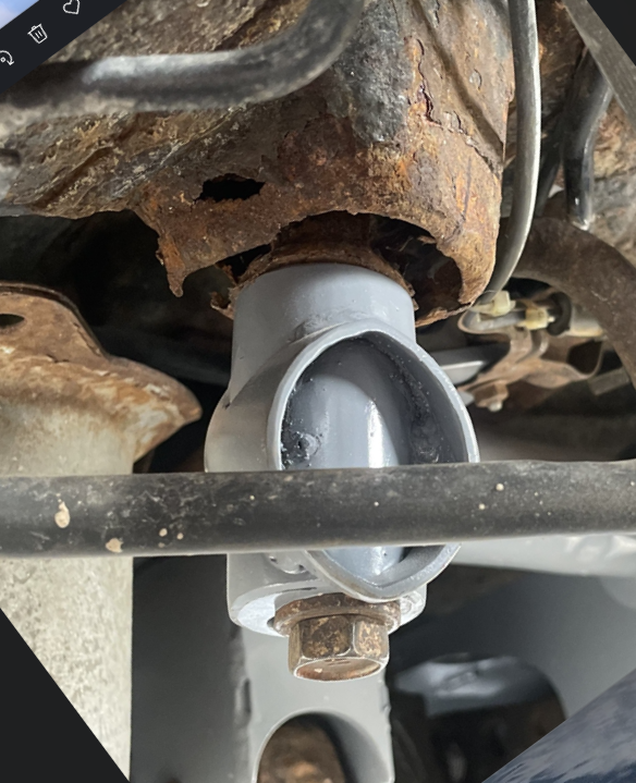

Once you're sure everything is oriented correctly, install the front subframe bolts to attach the arms, through the bolt sleeves, to the vehicle.
As you're tightening them, pay attention to whether the arms are pinching or binding anywhere.
This is the step where all of our previous human error and sloppiness resolves itself--inaccurate bending, hand drilling for the bolt sleeves, eyeballing the drilling angle--it's all gonna come out in the wash right now.
Check again that you've installed the upper control arm ears correctly. Last chance. (Blue arrow)
We have 2 positions that we know are correct and that are locked in: the location of the bolts, and the holes in the laser cut subframe plates.
All we have to do is guide our bent tube to the best fit between those positions.
We have 4 primary dimensions of adjustment to accomplish that (Red arrows):
1) The arms can rotate relative to the subframe plates
2) The arms can move forward and backward relative to the subframe plates
3) The arms can move up and down relative to the bolt sleeve
4) The bolt sleeve can rotate in the arm, moving the bolt hole (slot) relative to the arm
And 2 more secondary dimensions of adjustment (Purple arrows), that should be avoided unless absolutely necessary because they compromise one of our fixed positions:
5) The subframe can move up and down relative to the rear bolt sleeves
6) The rear bolt sleeves can rotate, moving the subframe forward, back, left, right, and at angles relative to the vehicle.
Again, these last two get messy. Only for those playing on expert mode.
Tightening the bolts down will do 95% of the adjustment automatically. The most you're likely to have to do is tap the end of the arms up or down along the bolt sleeves.
You'll know you've found the right position when the front bolt sleeves are tight to the vehicle and visibly straight.
Here are some pics from the future of roughly what you're looking for:

Once you're in the right position, tack the tube where it passes through each plate to lock everything where it is. We want to do the least welding possible with the subframe on the car, so 4-8 tacks per side is plenty. I put a thick towel over the gas tank to insulate it from sparks and my arc from gasoline vapors. Taking the gas tank out would have been better. Use your judgement. It is also good practice to disconnect the battery.
Tacks done on the vehicle:
If you left your gas tank in, DO NOT tack the front bolt sleeves to the arms while the subframe is on the vehicle. If they're tight enough for a friction fit, great: take the subframe off and tack them on the bench. If they're too loose for a friction fit: trace the edge of the hole in the tubing where they meet so that you can find that exact position again on the bench. DO NOT BLOW YOURSELF UP TRYING TO SAVE A STEP. I know the temptation is strong. I too have felt it.
Tacks done on the bench:

Once the holes are marked, drill them out with a 1/4" or smaller bit to guide the hole saw
and then drill through with the hole saw
You'll get something like this (you can see from the two little notches that I forgot to add the half tube diameter)
which you can clean up to look like this
and finally fit into place like this
