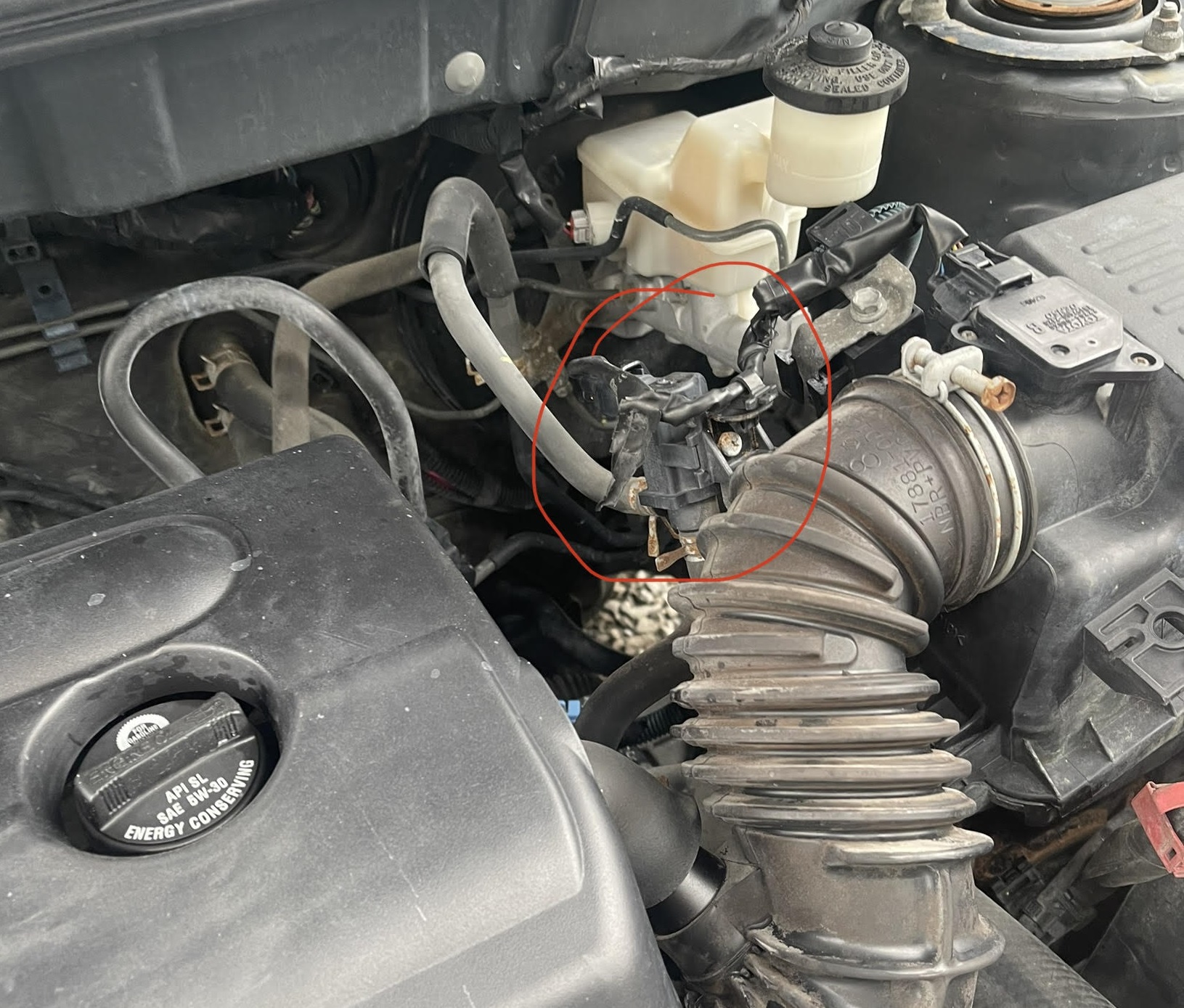

I am trying to ID the name of a part on my 2006 Pontiac Vibe with the 1.8L engine. This part is mounted off the side of the intake tube and has what appears to be a 3/8" (maybe vacuum line) hose frome the motor plugged into the bottom and another house off the side that goes down the firewall on the drivers side. It has an electrical connection plugged into it also.

It might be a vacuum switching valve for applying vacuum to the gas tank for evaporative emissions control.
can't be sure from the picture, but does it look like this matrix VSV on ebay?
https://www.ebay.com/itm/125144169887

Thank you. That’s exactly what it is. An emission purge valve. I have one it’s way. It is making a horrible ticking sound. Sounds like a lifter ticking but it’s coming from the module.
Re: Trying to Id a Part
a lot of folks have noted the VSV ticking loudly, but its not necessarily an indication of it being bad, more like just the nature of the beast, so a new one might still tick loudly
