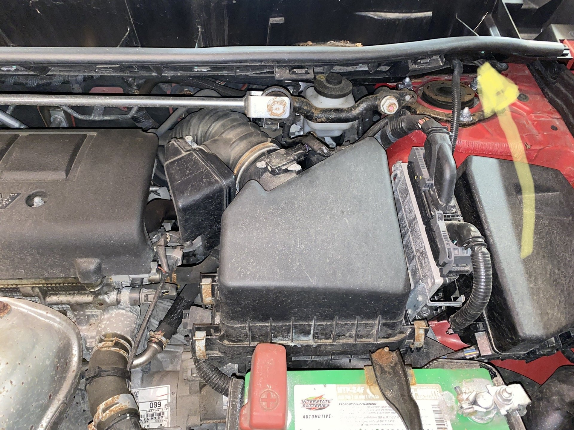

Thank you. I popped the hood and noticed a cable dangling. I've changed the air filter before and never noticed this. Could this be part of the problem? I can't see anywhere to connect it?

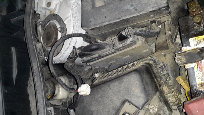

Another view

YES !!! That is likely the 5 wire connector (although all the colors don't match up to the wiring diagram exactly) that plugs into the wiper motor. How that would have come loose or apart is a mystery. Anyways you can see on my Vibe where the black loom of wires heads under the cowl and is out of site. That's likely where the motor is. My photo is of the bigger 2.4 L engine PLUS I have a strut bar in the way as part of the GT package.

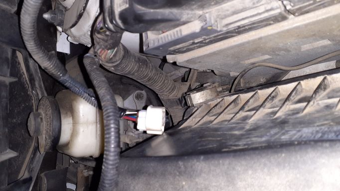

Just dug up an older file photo of my son's Vibe Gt and you can clearly see where that loomed bunch of wires go..... to the wiper motor! It's likely that the motor got changed recently and somebody didn't plug it on tight enough, then you messing around nearby COULD have pulled it out.
