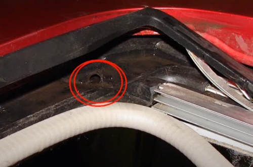

Re: 2005 Moon Roof Leaks
jmvvibeowner wrote: Wed Aug 17, 2022 5:00 pm Thanks Jolt for the advice. I'm a little nervous about pulling down the interior trim and headliner, so I'm going to have to think about what I'm doing next!
You don't need to pull any trim to check the front moonroof drains holes. Just slide the moonroof open all the way, then stand up in the hole and look in the corner. You'll see a hole in each front corner, as shown in this picture, which shows the front passenger drain hole
Take a cup of water and pour it in slowly, to see if it drains. If the drain is clear, it will drip out outside between the door and the front wheel, and that's not your problem. If it doesn't drain, then you'll need to find a way to clear it.
