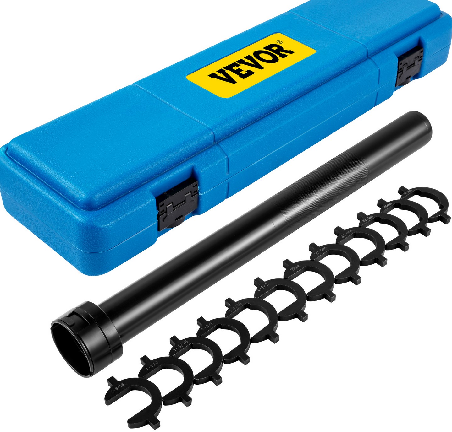

Would like to interject/ add some insight here. While most folks would probably be fine with the inner tie rod tool shown (the black clamp with teeth type) I've found the BEST bar none is the OEM TOOLS master inner tie rod tool it works with EVERY TYPE and to me well worth the money. I've spent more time setting it up than actually getting a tie rod off every time AND since it slides over directly you can use an impact to speed things along breaking it loose.
That said, the suggestion made about replacing both at the same time is solid. Aside from the rust issues mentioned the way I tend to look at it is if the outer needs doing the inner isn't far behind and might as well while you've got it apart. Other suggestions for ease of work is with stuck castle nuts and especially jam nuts if they don't budge just cut them. An angle grinder if you got room and they are fairly cheap, or a die grinder or cut off tool works too. Just put 1 or 2 slits in the nut and it'll pop off and you can keep going. My recommendation for any DIY'er is milwaukee. They back their tools and batteries and tend to have the best rating for use, torque, power, etc on the market. I work on my own vehicles but also help out some family members and while I've only used my inner tie rod tool on 3 vehicles (6 times) the 89 I spent was saved in labor costs for just one. The die grinder runs 200 plus a battery or get the pack of both straight and right angle for 350 with batteries. The cut off tool is a bit cheaper at 150. Just my 2 cents AND those tools can be used for a whole slew of other stuff as you've probably seen on multiple YouTube vids
