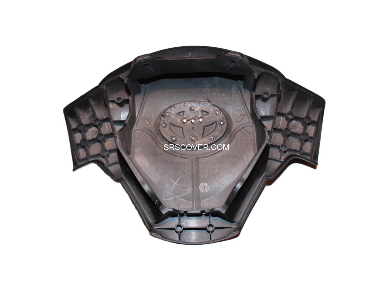

The biggest deal is removing the "wings" off the sides of the airbag to make way for the steering wheel controls. The plastic cover cannot be removed from the airbag itself, but once you remove the airbag from the car, you can use a sharp knife to repeatedly score a line following the grooves, then when the groove is deep enough, cut the rest of the way through with the knife. If you screw up or do it perfectly, there's really no going back. You'll also have to trim some of the ribs off the back using a knife or side cutters. I've included two pics of the backs of the base airbag and GT airbag so you can see the difference.

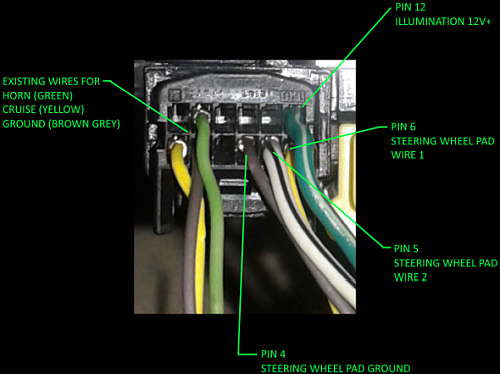

The big question of course is, what about the wires from the clockspring to the radio? I've included a pic that shows the wires you have to add and where to add them. Then you can solder and shrinkwrap to longer wires back to the steering wheel interface module. Colors don't matter, just make sure the wire goes to the right place. I got my wires from other Vibes at the junkyard for free, which is important since the metal pins on the end are small and delicate and they break, so get extras. Wires from 1st or 2nd gen will work, and probably other Toyota's, too. Sorry I do not have pin-outs for adding steering wheel controls to a factory base radio.
There is an optional 12V illumination line, but the LEDs are really bright orange and are distracting. They don't seem to dim with the dimmer knob, either. They are tiny and soldered to the PCB in each pad, so not worth changing them. So I'm probably going to disconnect them.

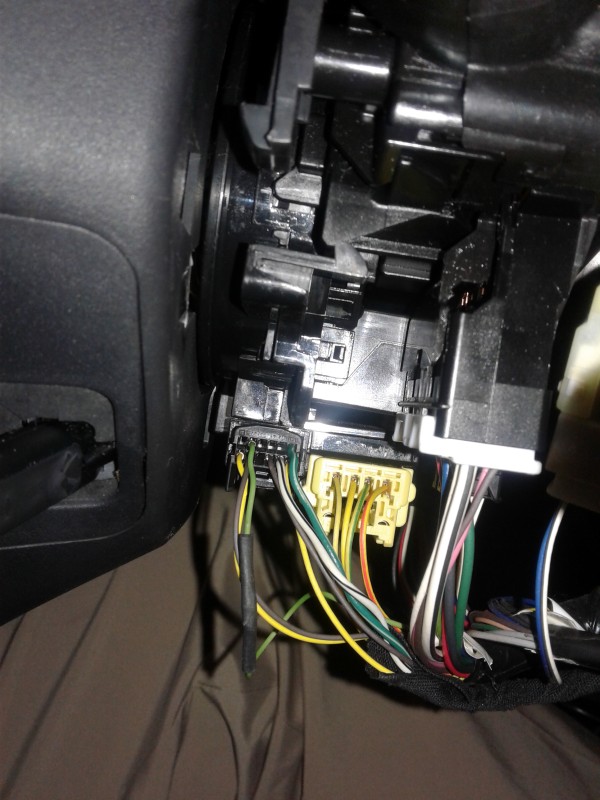

View with bottom of steering wheel cowl removed, passenger side view
Close up of wiring plug on bottom of clockspring

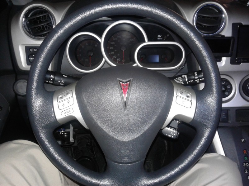

Completed project.
Completed project.

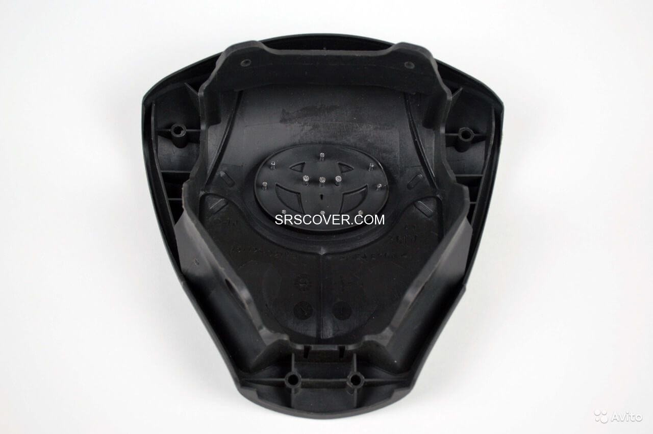

Airbag example photos.
2009 Vibe Base

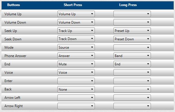

The PAC Audio SWI-CP5 offers both desktop PC and smartphone apps to configure the buttons easily. This is the button mapping I used, choosing a 2010 Corolla to start with. With this config, holding down the source button turns the radio off, and holding down the voice button activates smartphone voice recognition. Tapping the voice button quickly again returns the radio to playing tunes.

Night view. Those LEDs are bright!
In the pic is an Ultra-Gauge EM Plus (the blue thing) and the HU is a Pioneer AVH-X4600BT.

Most excellent documentation Macgyver! :D I'm assuming that you cut the molex connector wires from the donor vehicle and inserted them into your own vehicle? If that is true, then it would be possible to purchase male/female Molex connectors, add the 18 gauge wire and replicate what you've done? I'm going to get a Molex kit and some wire and run it from that harness in your picture back to the 14 pin factory harness at the stereo to bring it back to factory.
http://www.ebay.com/itm/9-Circuit-Conne ... U6Nmi#rwid
MacGyver
Posts: 340
Location: Ottawa (09 Base)
Re: How to add steering wheel buttons to an 09-10 base
Post by MacGyver »
pakong wrote:I'm assuming that you cut the molex connector wires from the donor vehicle
Yes, I just cut off the whole molex connector and about six inches of wire, popped up the donor molex retaining clip with a micro screwdriver, and then pulled the wires out. Then reinserted them into the existing molex connector and press down the retaining clip. I have a bunch of these things in my workbench, but none of them would fit into the molex, so that's why I went to the junkyard. The ones in your ebay link will most likely not work, as they don't look the same.

If you look up part 84250-02200, it comes with both right and left sides wired together. You replace both because they share wires. You don't need to add any wires from the clockspring to the radio if you already have steering wheel controls, as the phone buttons work off the same wire SW2 that the mode button does.
I'm probably going to disconnect the illumination wire entirely, mainly because the orange yellow color is too distracting. Everything else in the car is white, save for the traction control button and power window switch.

Great page!, I was able to make it work ! thank you so much for this,
QUestion?? where I connect the Green cable for the illumination ?
Thanks in advance.
