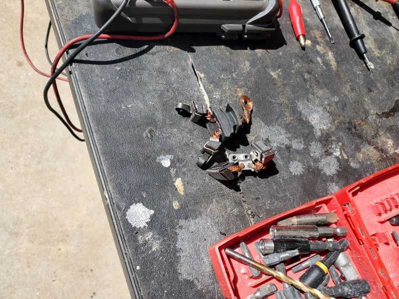

So the non-start happened again just as I was about to drive to Las Vegas for an event. A hammer brought it back to life and thankfully no other non-starts for the rest of the trip. I did carry a hammer with me.
Took it apart and sure enough it was the brushes. There were unevenly worn - two were much worse than the other two and one was worn almost all the way down to the holder. Not sure if it can be seen but it is the one of the far right.
I have some new brushes on order. I also took the starter fully apart and cleaned tested everything but other than the brushes everything else looks good.

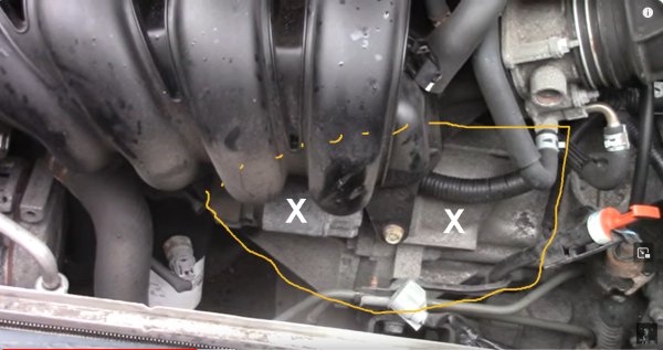

Apparently I have the same starter issue with my 2005 Pontiac Vibe. Even though the battery is fully charged, I don't even get a click when I turn the key. I am 81 and not too mechanically inclined.
Does anyone have a video or photos showing where the starter is located, and where exactly to hit it gently with a hammer, then start the car?
Will I have to crawl under the car to do it?
Once I get it started I can take it to a mechanic to have the starter fixed.
JC
Posts: 10262
Re: Starter Issue?
coppens1 wrote: Tue Oct 01, 2024 7:55 am Does anyone have a video or photos showing where the starter is located, and where exactly to hit it gently with a hammer, then start the car?
its on the front right of the engine, by the transmission dip stick (assuming your 05 is an auto tranny), no need to crawl under
I grabbed a frame from the starter replacement video at https://www.youtube.com/watch?v=3Xzj-npWSh4 and drew a shaky line around the starter, and put white X's on 2 possible places to try whacking it
