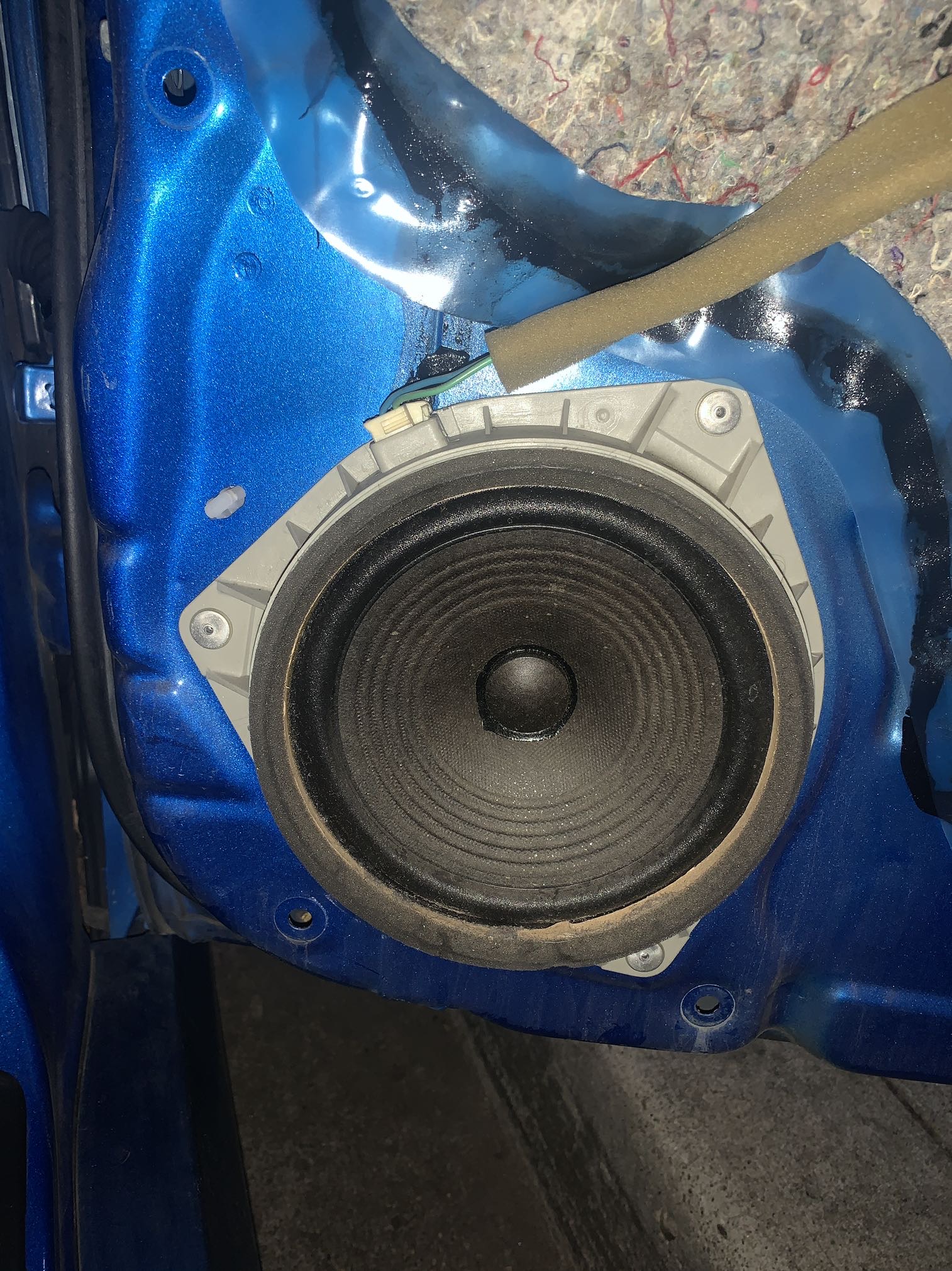

Here is the factory speaker:

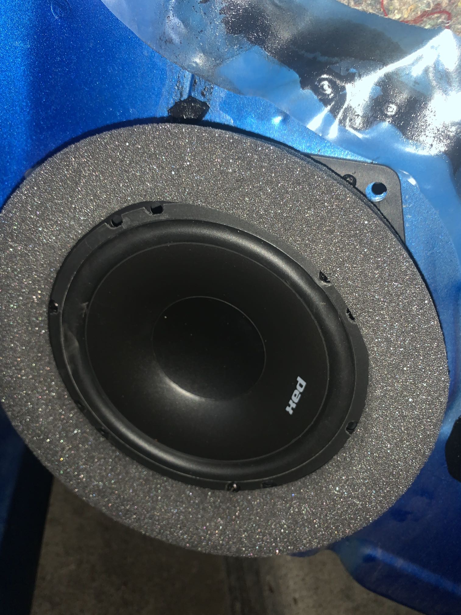

A quick drill to the rivets and the assembly pops out. I mounted the new 6.5" to the adapter bracket and it goes neatly in place. Since this is a component set and not a coaxial, the OEM wire connects to the crossover. Then the supplied speaker wire connects to the crossover. The tweeter also connects to the crossover. If you want to make your life easier, just get a coaxial unit and call it a day.

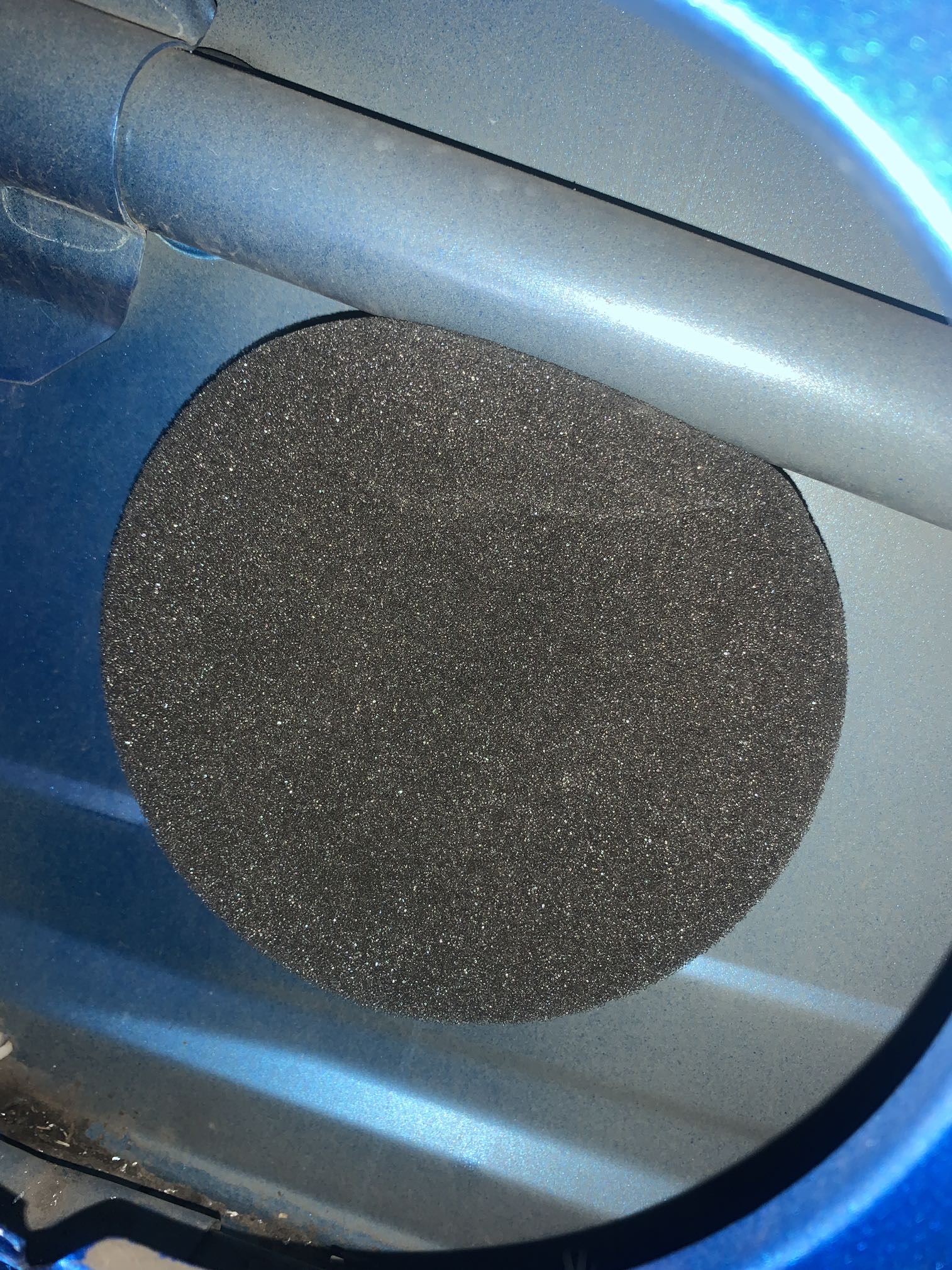

The foam kit had a piece that stick to the door so that the speaker rear sound is not bouncing off the door inside.
Another piece goes on top of the speaker to fill the gap between the speaker and the door panel. The kit that I bought was a 2 piece, but the kit that I saw on a good video was a 3 piece which had a ring inside the back of the speaker to send waves toward the back foam. This would have been ideal I think.

I was diving DEEP into the interwebs to find the most budget and most well reviewed 6.5" speaker out there. These cerwin vega speakers are poorly made as found when I took a closer look at the speaker that I had not installed yet. I should have known this. There were hardly any good reviews, most of the complaints were that the speaker was not actually 6.5"
After looking through my door panel grill, I could clearly see the speaker area was way small compared to the grill cutout. The frame is 6.5" but the speaker area is small. The speaker material feels cheap, i could push my finger through edges just barely touching it. Obviously these are some crap speakers using the cerwin vega name. I played some music with the door panel off and you can see the speaker shaking it like a salt shaker way too much. This was my rattle. The speaker was just over working itself. You get what you pay for is true in this case.
Fast forward, I found SKAR 6.5" midrange speakers which are VERY popular through reviews and youtube. It is just a speaker, no hardware wiring or tweeters are included. It is meant to be a replacement/upgrade only for 6.5" factory speakers. They work well as stock replacements but handle heavy duty amp work as well according to the masses. Out of 1100+ reviews on amazon they are still at 4.5 stars which is surprising as they only cost $20 each.
It sound decent just on a quick hand test. So I thought why not keep the component setup and just replace the crap mid with the skar one keeping the crossover and tweeter. After a quick swap, the results are like night and day. The speaker is no longer flopping (it has a strong surround). Also on a high volume level when I switch to the left side OEM speaker which I did not change it, it sounds terrible.
The foam ring that goes on top of the speaker I found is a perfect match for the door panel. When I changed it, I noticed that the plastic ring made a nice sealing imprint on the foam ring. So that was a win win.
