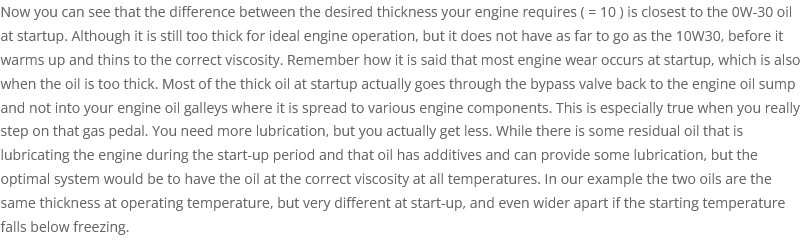

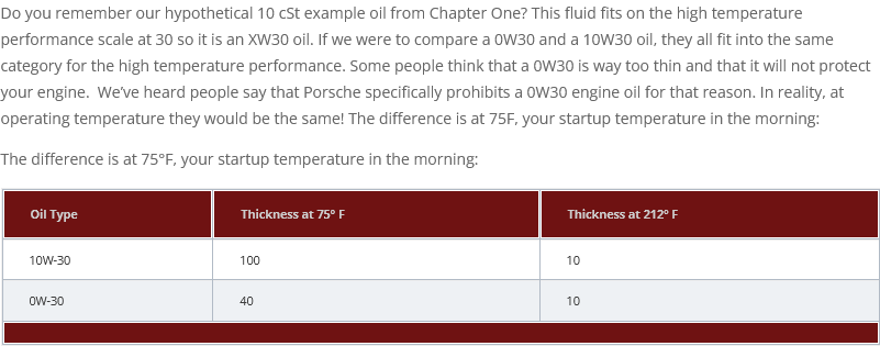

Here's a snip from chapter 2 of Oil University at BITOG that explains it better:
Chapter Two - Oil Grades - Bob is the Oil Guy.png (34.67 KiB) Viewed 2725 times
Oil University is an awesome resource that I think everyone should read. https://bobistheoilguy.com/motor-oil-101/

My point is that the weight you need is relevant to your starting temperature. You've even pointed that out yourself. You then went off on a tangent about 0 weight oils going to all sorts of low temperatures. You missed the point.
The point is that the initial flow viscosity _at startup_
