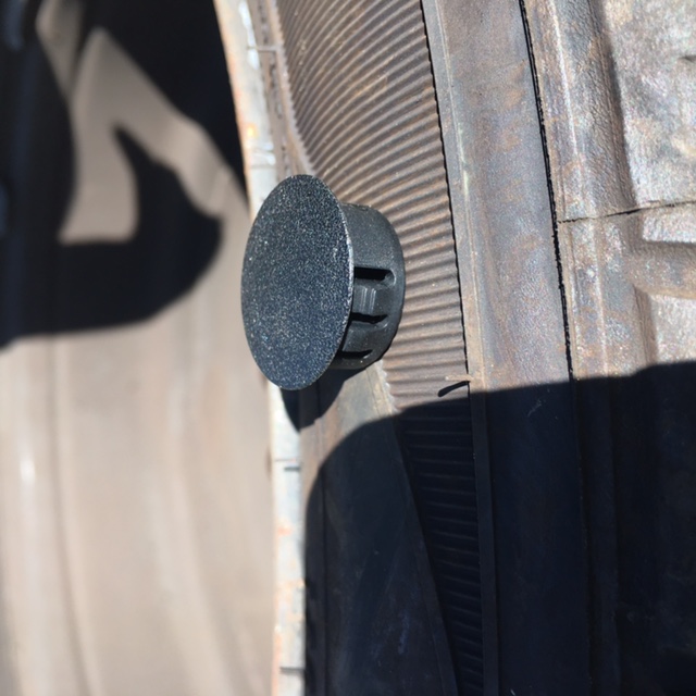

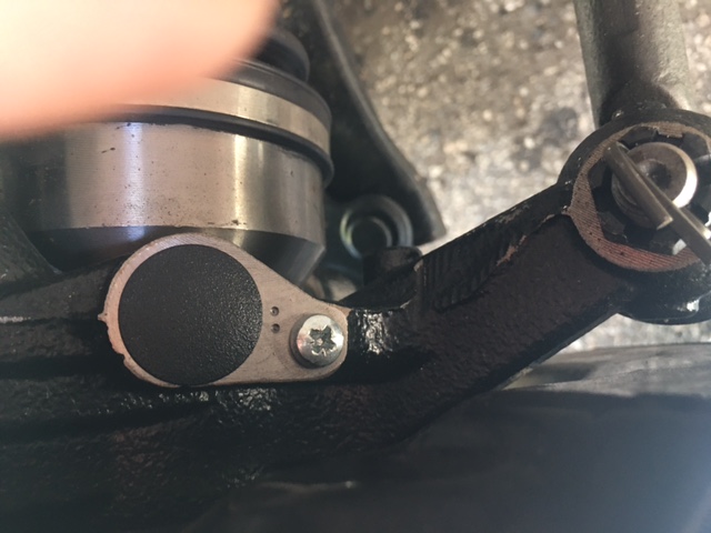

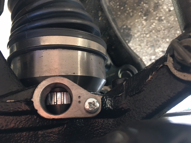

Well thanks for the info. So it seems that the only difference is the Matrix steering knuckle has the hole for the ABS sensor. My 08 didn't have ABS. I just put a cap in the hole and a screw where the hold down screw would be.
