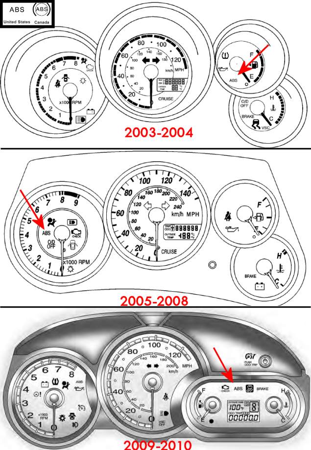

tnpartsguy wrote: ↑Sat Nov 26, 2005 11:47 pm turn the key on to the 1st click, NOT START! All the idiot lights will test, if you have one that shows ABS, you have it, if you don't, well.....you don't.
ome on man, cant this thing post pics man ? ... pic of abs on your dash man so we know where to look come on man ?!!
man need a clue like center cluster , right dial or left .. come on man .. some doosh in the advance auto actually wanted my license plate number to look this up .. after some jabber jawing i aggreed to the other option his shitty computer gave him which was
VIN number .. so he goes out to take pic of the VIN on his personal phone , comes back into store to look it up .. and guess what .. fubmbles around when i repeatedly ask ' .. well we got the vin ,.. does it have ABS .. after erpeated questionsing ... 'well it doesnt always tell' ... i fealt dumb for having gone through this procedure !!!
Posts: 10267
Re: Re:
dale321 wrote: ↑Fri Jul 02, 2021 4:51 am
... pic of abs on your dash man ...
dale,
Here is a pic showing the location of the ABS indicator light from the owner's manual. I looked through your posts and can't see where you ever said what year Vibe you have, so I put the three cluster layouts, 03-04, 05-08, and 09-10. Inset in the top left shows the different icon for US and Canada, similar for all three cluster versions.
Looks like you got your Vibe used, so in case you didn't get an owner's manual with it, you can download PDF versions for all years from https://forums.genvibe.com/phpBB3/viewtopic.php?t=755
