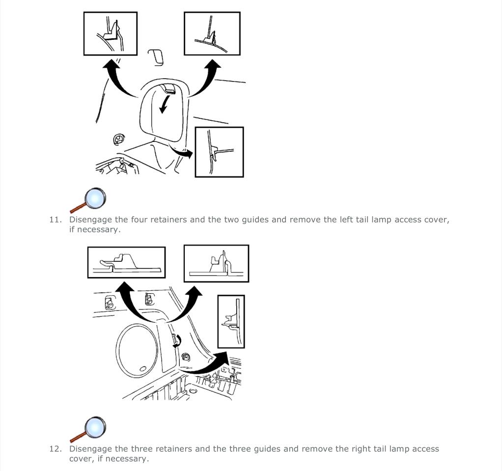

Cpasley wrote: ↑Thu May 13, 2021 7:17 am ..... how do I get that panel off so I can investigate further.
The attached images show the removal of both rear lower trim panels, you only need to do the one. My guess is that the speaker is bad and needs to be replaced.
Quarter Lower Rear Trim 01.jpg (74.16 KiB) Viewed 1731 times
Quarter Lower Rear Trim 02.jpg (45.71 KiB) Viewed 1731 times
Quarter Lower Rear Trim 03.jpg (57.75 KiB) Viewed 1731 times
Quarter Lower Rear Trim 04.jpg (74.85 KiB) Viewed 1731 times
