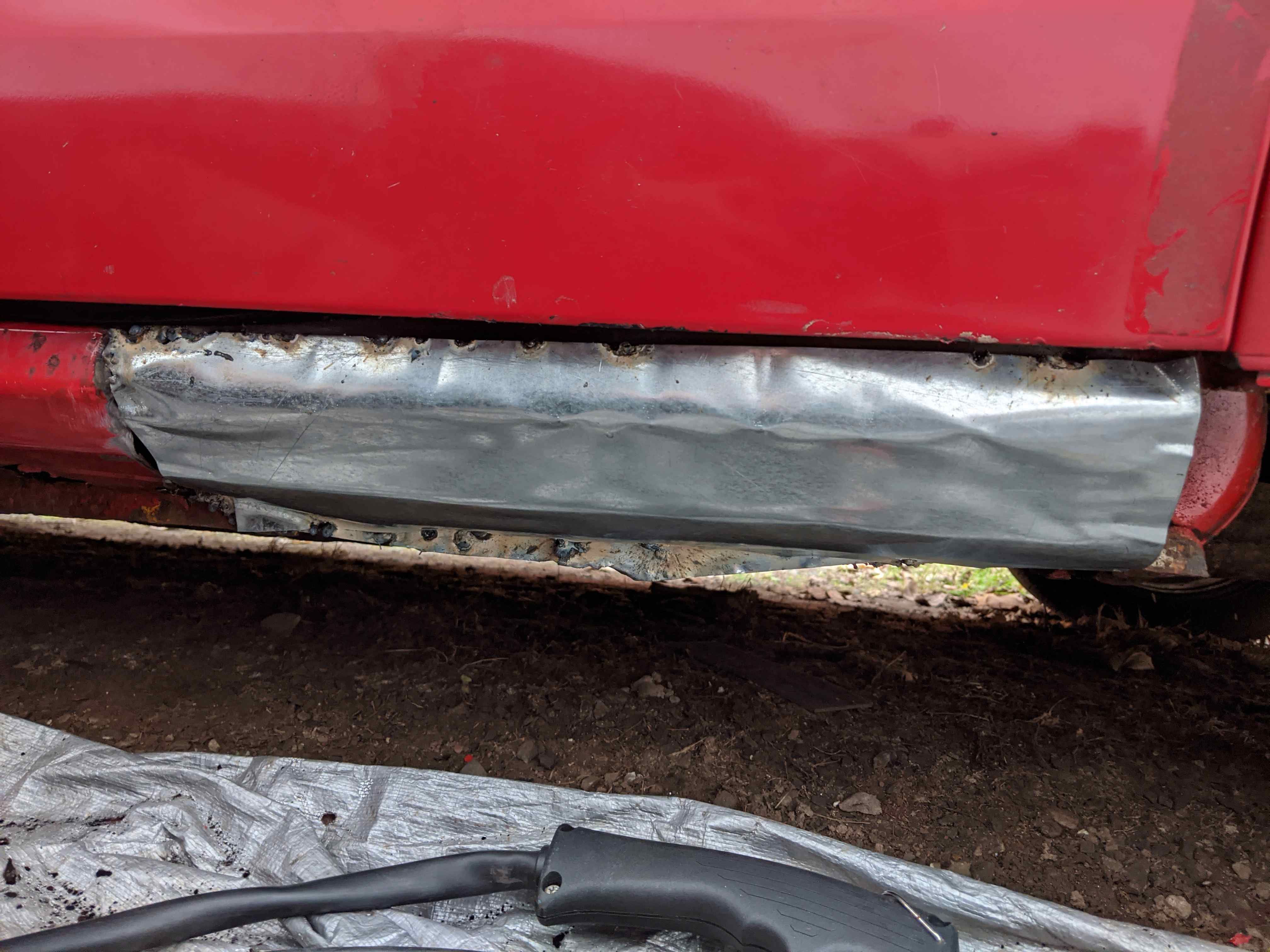

I picked up some 18 gauge sheet metal today, turns out it's a little thinner than the inner rocker and a little thicker than the outer rocker but it'll do to get me on the road. The plan is to prep the surfaces, tack weld the top of one sheet to the top of the inner rocker, then tack it to the start of the first bend in the inner rocker. With the rocker support still in place as pictured, the tack and the support should allow me to bend the sheet around the first corner. At that point I'll line it up with the factory pinch weld and tack it before finishing up the rest of the welding. I'm planning on following these steps for the outer rocker as well, but I have to wait for some warmer weather this week. For longevity I'm planning on hitting everything in reach with some rustoleum before and after welding. The end of the rockers towards the rear wheel wells are going to be capped with a section of the 18 ga as well, cut to shape with some shears. As I go I'll try to make some measurements and CAD up a sheet metal section that should be useable.

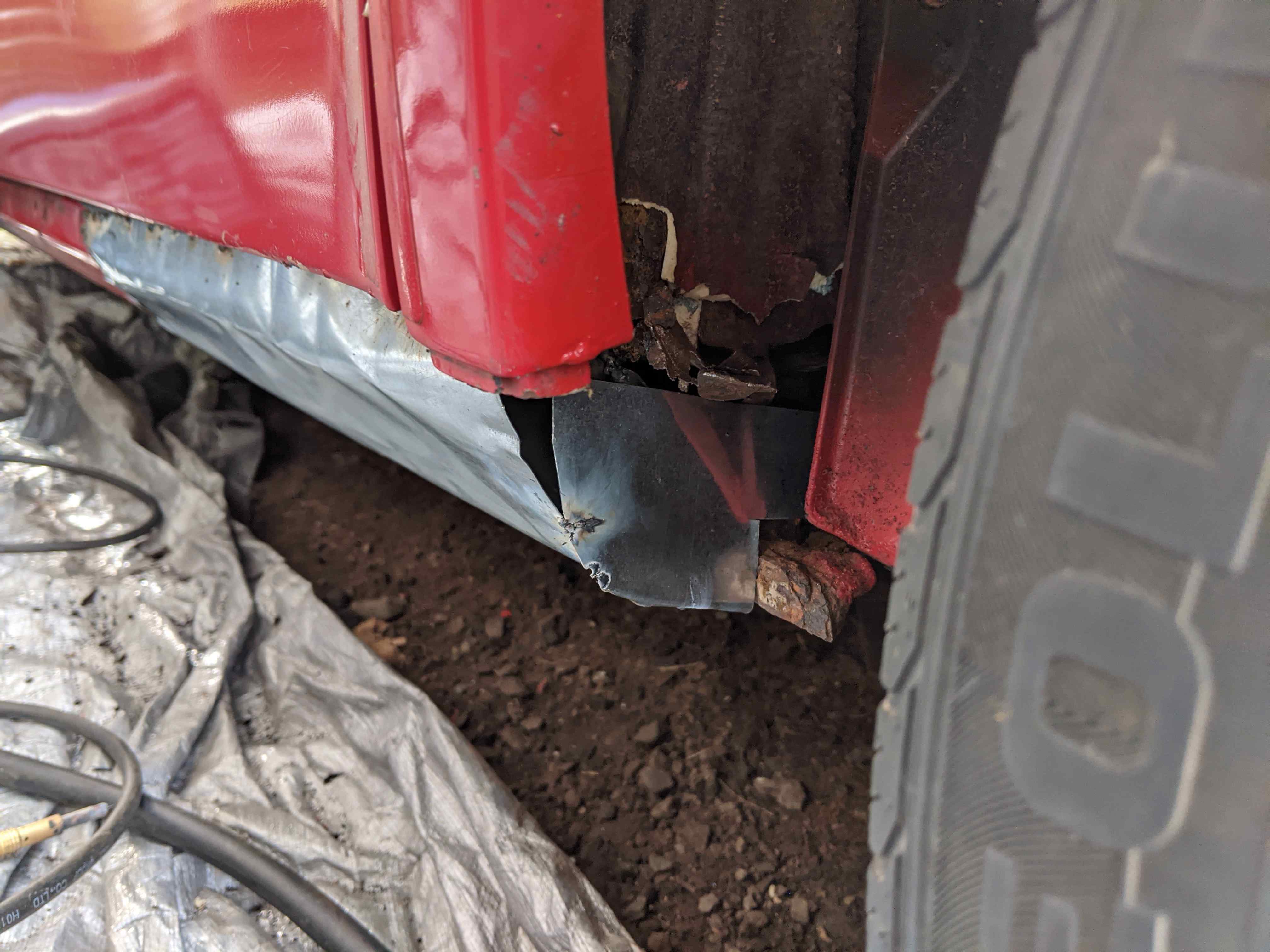

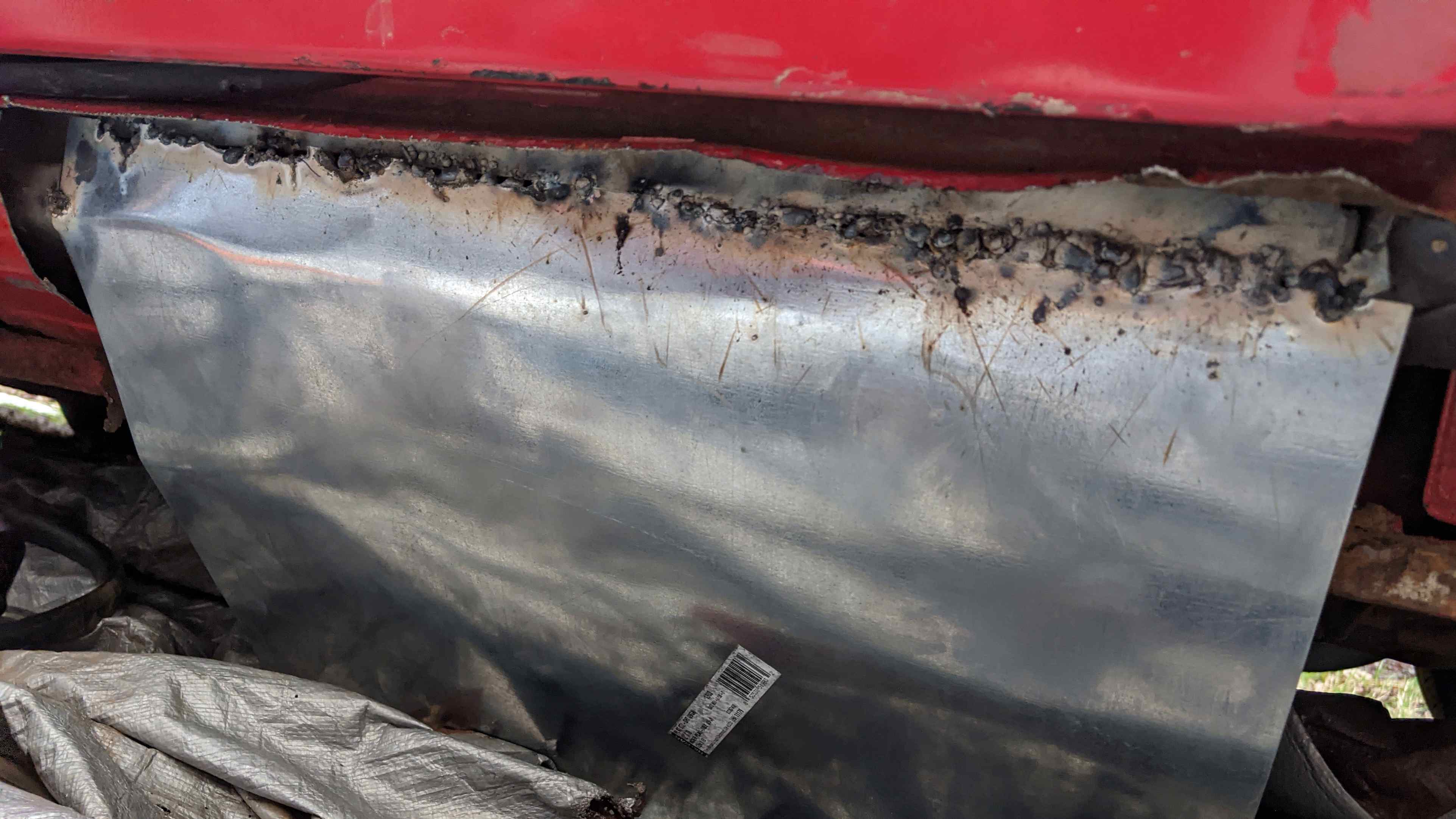

Started welding in the inner rocker today after patching the rot above the pinch weld. It's my first time really welding so the whole process is a new experience (Go easy on my boogery welds :lol: ). I have the sections of rocker I cut out to make measurements and the CAD file as requested, any tips for posting those files or where I should post them? I can tell this might be a bit of a slow process due to weather, but I'll update as often as I can.

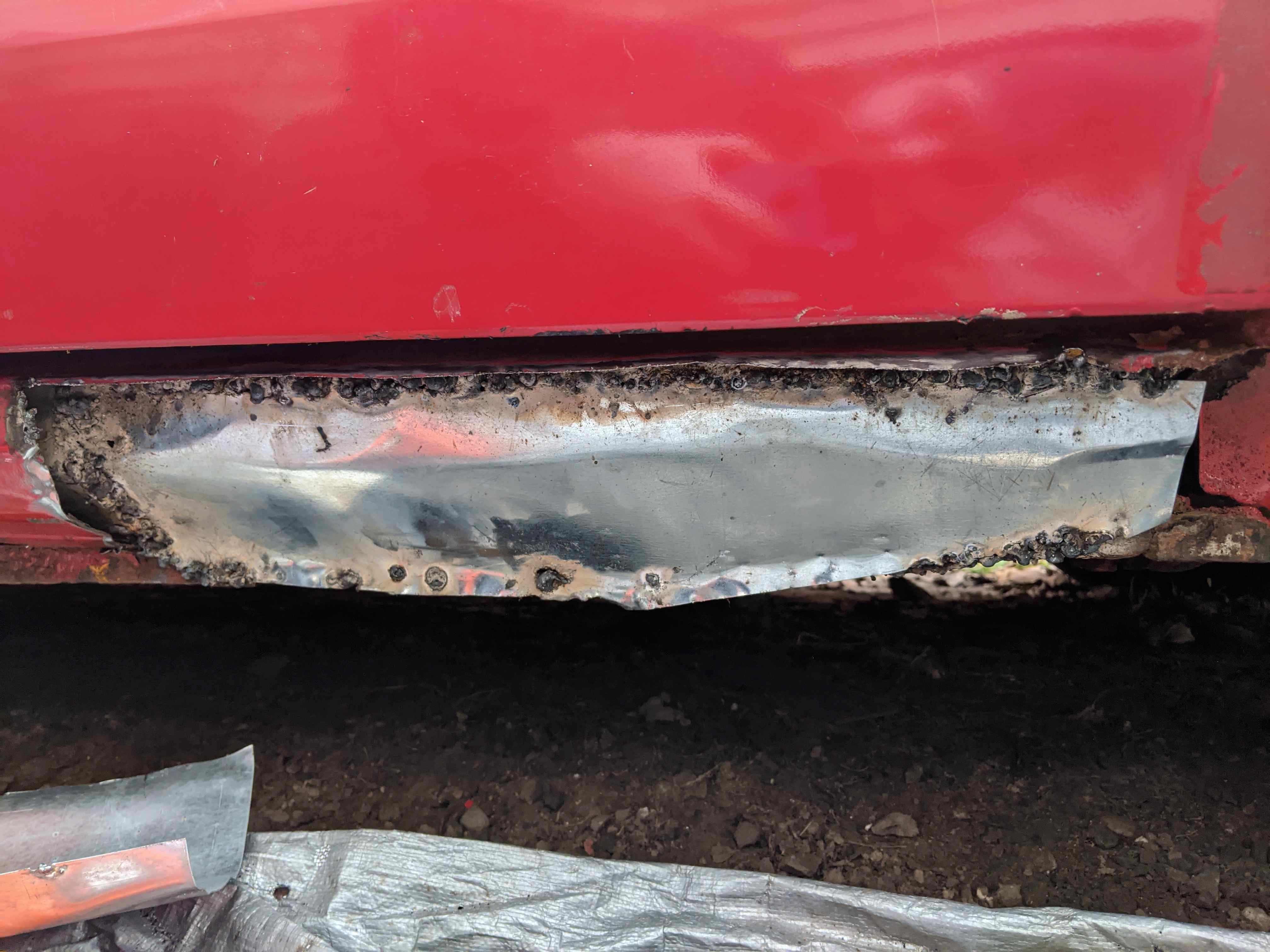

The rocker saga continues! Found some nice weather and got the welding on the driver's side finished up. It's not pretty, but bondo and paint make me the welder I ain't!
For a first time really doing any metal fabrication and welding, and without many of the proper tools and doing it outside, I think it turned out okay. I also took dimensions and made some CAD sketches for anyone looking to have replacements made. I can also add the 3d files and measure for the rocker cover holes if there's demand for it, right now it's just the solid bent sheets with a bent over end cap in the drawings.
