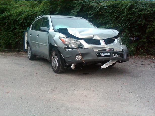

The transplant patient.
Ghost of Dirk1.jpg (93.08 KiB) Viewed 36714 times

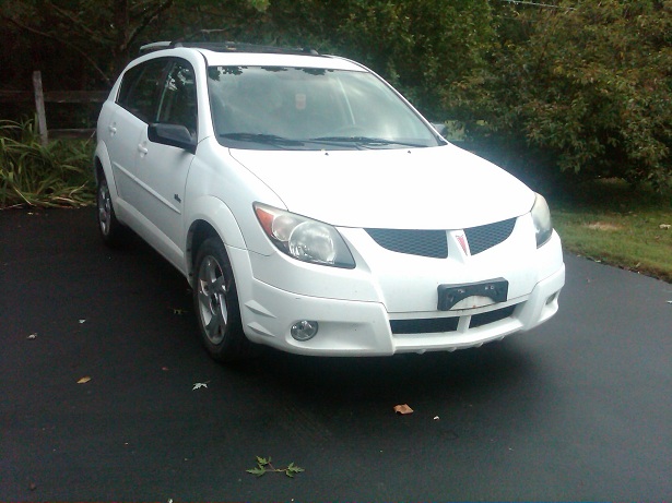

The donor car.
The donor car.
Dirk the Doner1.jpg (113.96 KiB) Viewed 36714 times
Thanks all! So far I have begun the process of taking the donor car apart. Unfortunately the photos of my progress didn't come out. But here are two pictures of the donor and the new car.

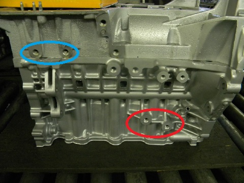

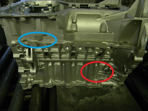

I got these pics off EBay Motors. Although the blocks in the pictures are upside down you can see the difference. The red circles show where the threaded studs are cast into the block, while the blue circle show where the right side bracket would bolt up. The FDW block pictured here is also slightly different from the one I pulled from my FDW car. Mine looks like the AWD block in the location of the blue circle but without the holes drilled and tapped. Weird.
AWD block
AWD block
AWD Block.jpg (64.92 KiB) Viewed 36640 times
FWD Block
FWD Block
FWD Block.jpg (63.33 KiB) Viewed 36640 times

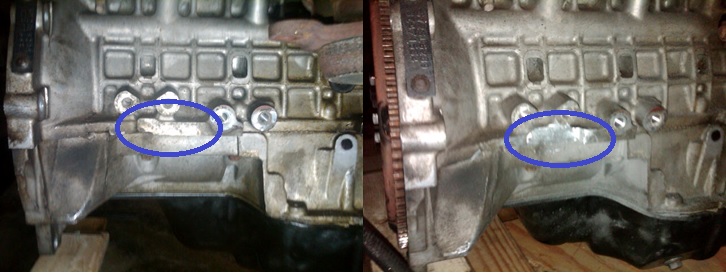

PROGRESS!!!!! I final got some time to focus on this project. Since I last wrote, I was struggling with making custom bracketry for the AWD differential. That was solved by having a custom bracket fabricated by a local guy who was very talented and cheap. The next order of business was to drill holes in the right side of the block to accept bolts that hold a second "C" shaped bracket that connects the right side of the AWD differential to the block. before doing that I decided to drop the oil pan so I could verify that there was material to drill into. Given what I have faced so far I figured I better be sure before potentially trashing a perfectly good engine by punching holes through the block.
Good news here. Plenty of material cast into the block for this purpose. So I cleaned up the pan, and the oil pick up while I was there, new gasket, and bolted back up. Lining up the holes was a bit of a chore but I took a swag at it figuring I could tune the fit later with washers or a grinder. I just used the bracket for alignment and went at it with the drill, then followed up with my 10x.125 tap.
One more block modification. The AWD differential has a protrusion that requires clearance of about 3/8 inches to be trimmed from the bottom of the block. after some cutting and grinding, I got the clearance I needed (see pictures).
Last night, I spent 3 hours futzing with the toque converter as I could not get it to completely engage all the way into the transmission. I finally got it all the way back onto the trans input shaft. Note for all. While you have the torque converter out make sure you get as much of the old crud out of it and put fresh fluid in. Finally, I dropped the block in and have it almost bolted up, including the "C" shaped bracket which fit almost perfectly. I also got all the electrical connections buttoned up.
Vibe Block mod.jpg (73.23 KiB) Viewed 36410 times

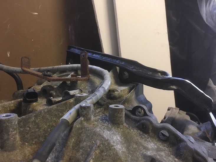

As a follow up to several PMs I have received about the custom bracket I had made for this project I wanted to share a few pictures of since it is now out of the car. I do not have an technical measurements on the car as it was done by hand and used the engine/trans/transfer case as the template. I hope that these pictures will at least show where and how it was attached.
Vibe Bracket4.jpg (122.71 KiB) Viewed 34341 times

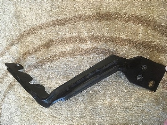

Additional photos of bracket
Vibe Bracket3.jpg (124.37 KiB) Viewed 34341 times

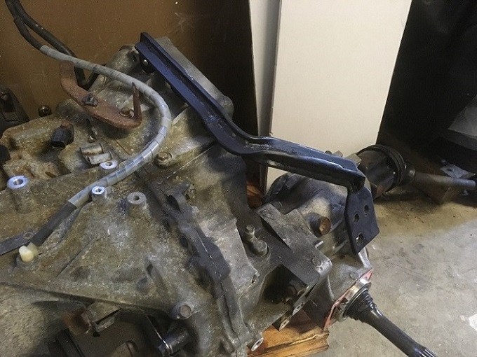

Last photo
Vibe Bracket1.jpg (120.67 KiB) Viewed 34341 times
