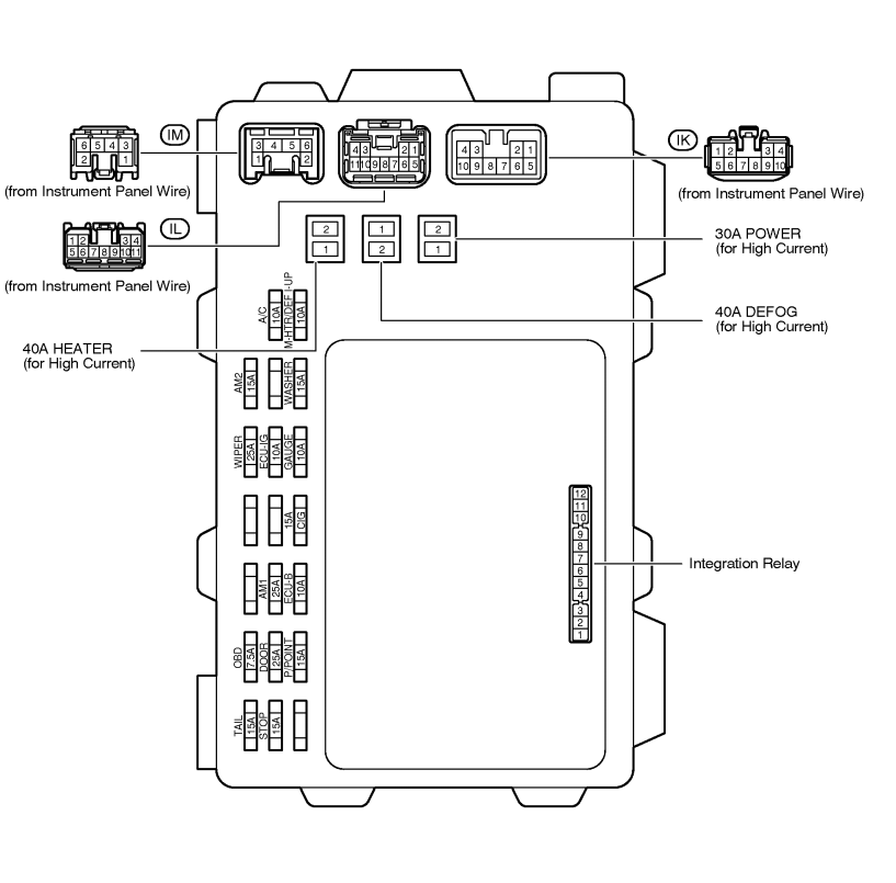

Hoping joatmon will see this, but I welcome any responses to my question. Would a bad heater relay (directly above the glove box) be the cause of no power to the 10amp fuse found by the steering column? I have no power (voltage) going to the 10amp fuse, car on or off, nor am I getting any power to the blower. Before I pull the relay box holding the 3 relays above the glove box, wanted to see if that's a possibility or should I be looking elsewhere for no power. Oh and yes the relay in the engine compartment is good. Thanks.
Posts: 606
Re: bad heater relay source of power failure?
Check the 40 Amp fusible link labeled HEATER in the instrument panel junction block. It's right above the fuses.
Screenshot 2021-02-24 201658.png (85.83 KiB) Viewed 2203 times
