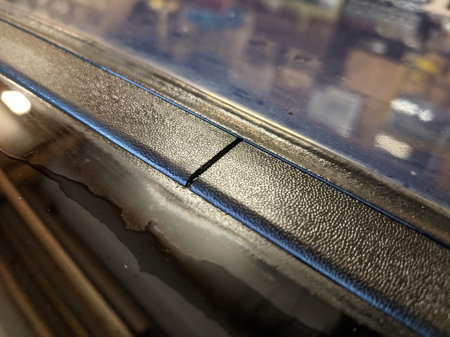

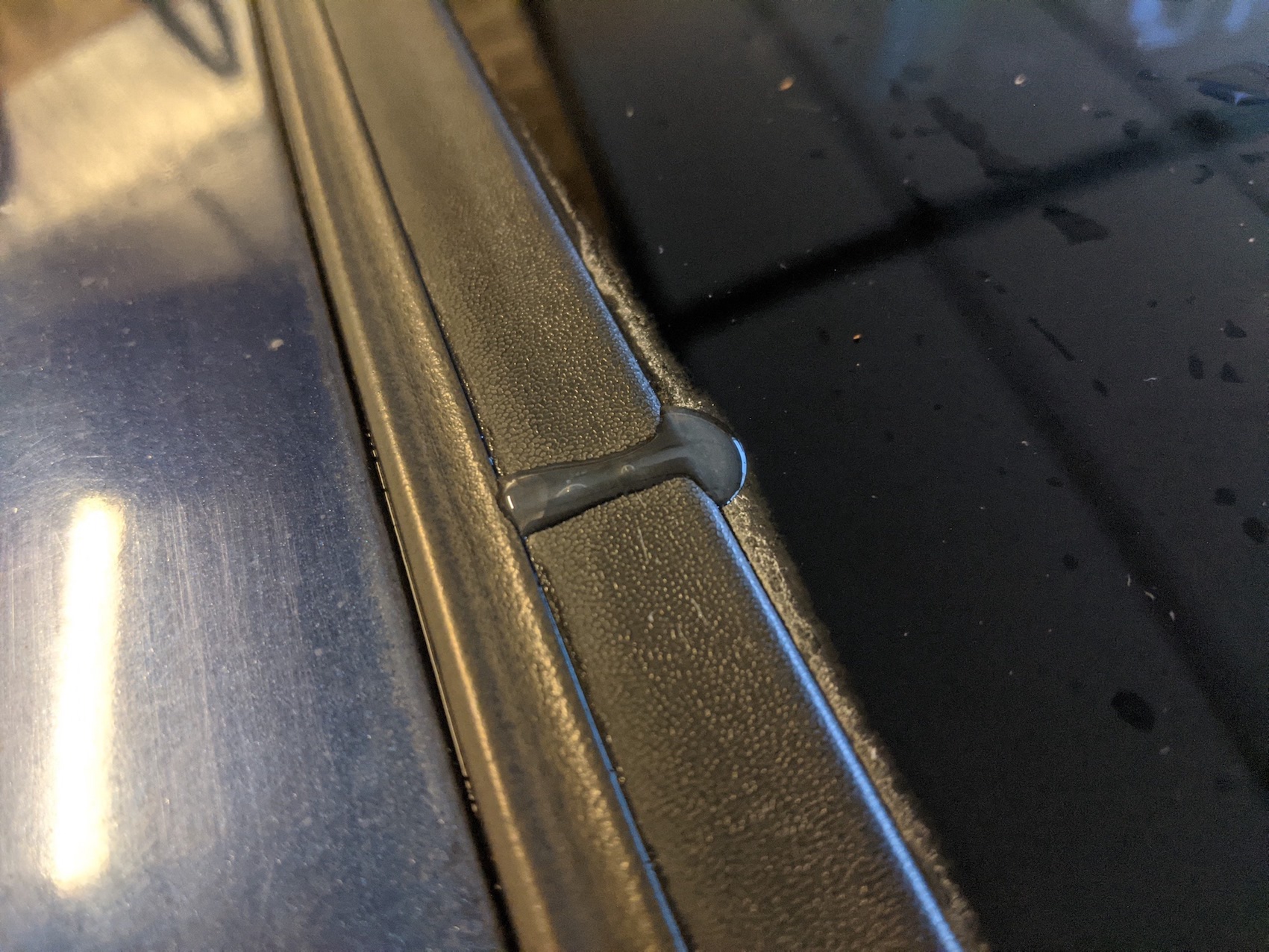

Alright guys, hopefully this helps someone out.
Sometimes, I've found, you can get very caught up heading down a path that you are sure to be true and overlook some simple things.
Turns out, after removing the headliner (and all of the interior pieces needed to do so), and hosing down the car while I sat inside, I found what I hope to be the issue. It was obvious, I should have noticed it sooner.
While watching for the leak, I noticed a very large amount of water draining from between the gasket and the glass (note, not the body and the glass), into an area of the drain pan that would typically be okay I'm sure, but it then gets stuck behind the glass and gasket and begins to leak in other locations along the perimeter of the seam between the gasket and the glass. From this location, it is draining onto the wind deflector, which is still in the pan, but I'm thinking there is something here with how it is traveling behind the gasket to other locations that is causing it to leave the pan and enter the interior.
So, how did it get there?
From that gap in the seal, it's a straight shot into the cabin. If you're sitting inside, you can see daylight. It's obvious, I can't believe I didn't notice it sooner since its the exact same issue I had on a Volvo a ways back.
So how do we fix it?
Bloop.
It ain't pretty, but it seems like it's done the job. I left the interior out for a week or so and everything is looking good. The passenger seat is still damp, but I think that's just going to take some time. But there is less moisture in the cabin (and on the inside of the windows), the floor is dry, and I've checked the roof after several rainy days and everything seems to be doing it's job.
So, if you've got some wet floors, or higher than normal condensation in the cabin, remember, just because everyone tells you it's the sunroof drains, doesn't mean it isn't the drains, but be sure to look elsewhere.
Carry on!
