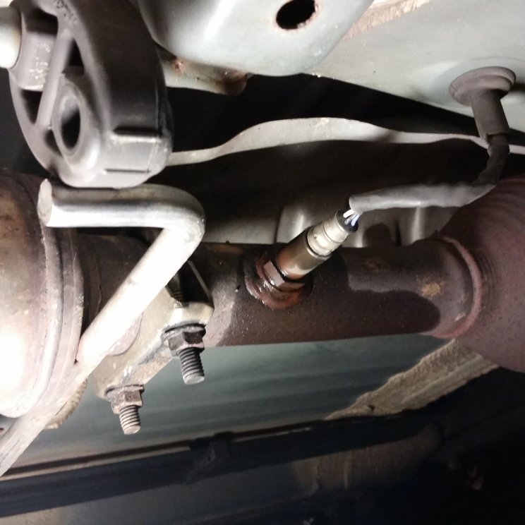

I got a 'direct replacement' catalytic converter to replace my current one, since Im getting a P0420 code. The size of the replacement cat and the size of my exhaust manifold are different. I have a 03 GT and the flange is bigger than the new pipe. Gasket is even way bigger. Question is, are the exhaust sizes different on a 1zz and a 2zz? Im assuming the GT has a larger diameter pipe? It was listed as fitting all vibes, base and GT.
I have an O2 sensor that no one else seems to have. Theres the one between the 2 cats and then one after the last cat and before the resonator. See picture.

What's the part number on your replacement one? Perhaps you were sold the incorrect one?

zbyers wrote: ↑Mon Jan 04, 2021 6:43 am What's the part number on your replacement one? Perhaps you were sold the incorrect one?
I got it off of eBay. They had it listed for a GT, but it doesnt fit. I believe it was for a 1ZZ base. The 2ZZ must have a bigger diameter exhaust and only one cat. They returned my money and told me to keep the cat. 8-)
