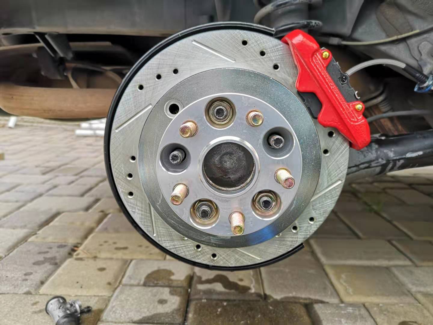

I successfully did the conversion with all new parts purchased online in 2020.
I put on a spaced because I also put on a big brake kit for the front brakes, you can ignore that.
It was a pitty that I did not took photo step by step since my hands were so dirty...
Parts:
From ebay
46503-20070 GENUINE OEM PARKING BRAKE PLATE ASSY, RH 4650320070
46504-20070 GENUINE OEM PARKING BRAKE PLATE ASSY, LH 4650420070
From Amazon
Callahan CCK11900 REAR Powder Coated Red [2] Calipers + [2] 5 Lug Rotors + Quiet Low Dust [4] Ceramic Pads Performance Kit
(I actually prefer none drilled or slotted rotors which cost about $30 a piece, but the price for the package was good by the time)
Carlson Quality Brake Parts 17402 Drum Brake Hardware Kit
Bosch BS796 Blue Drum Parking Brake Shoe Set for Select Pontiac: 2003-06 Vibe; Scion: 2005-10 tC; Toyota: 2000-05 Celica, 2005-09 Corolla, 2003-08 Matrix - REAR
(I bought Wearever S796 brake shoe from Advanced Auto part at the begining, and found it not fit, the shoe size is tiny bit too long)
8pc M10X1.25X35mm JIS Hex Head Flange Bolt 14mm Wrench, Class 10.9 Plated Yellow Zinc for Automobile, Motorcycle, and Mechanical Applications
(longer bolt is need since the brake plate is thicker)
Techna-Fit Brake Lines TOYOTA 2005-2006 COROLLA XRS REAR DISC REARS (2) - TOY-930R
Carlson Quality Brake Parts 14147 Guide Pin Kit
From Toyota dealer (online order, in store pickup)
1pc 4760232030 Parking Brake Lever (Left) Lever, Parking Brake Shoe.
1pc 4760132030 Parking Brake Lever (Right) Lever, Parking Brake Shoe.
2pc 4761332030 Parking Brake Strut (Left, Right)Strut, Parking Brake Shoe.
Optional
I bought some M10-1.25 Flange Nuts to hold the assembly temperarely so I can have more open space to set up the parking brake
The parking brake set up is very similar to Yaris, you can find the video on youtube
Major difficulties I met:
The original parking brake cables are just fit, I keep them untouched, but need to trim/sand the head size down (I use dremel tool) to fit into the toyota brake lever. The parking brake cable need to be tightened by about half inch at the handle side in the cabin.
