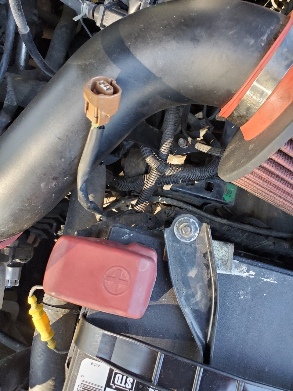

Recently purchased a 2005 vibe GT with a lean code, P0171. Only modification to it seems to be a cold air intake. I have a loose connector that I cannot find what it connects to. It had a pin in both terminals, so the previous owner was trying to jump the connection. Any help? If anyone has a stock air induction system or even a cold air/short ram on a 2zz engine that they can contribute pictures of the setup, it would be greatly appreciated. Basically I need pictures of all vacuum hoses and electrical connections that are apart of the air intake system.

Heres another picture to show the set up. That hose laying over the top of the intake isn't there anymore. I can supply more pictures if needed
Posts: 611
Re: Help identifying loose connector
Looks like the fog light connector. If your car doesn't have fogs, it may be an unused extra on the harness. There may be one on the other side too.

andrewclaus wrote: ↑Mon Nov 04, 2019 5:05 pm Looks like the fog light connector. If your car doesn't have fogs, it may be an unused extra on the harness. There may be one on the other side too.
Car does have fogs, but they currently work as they should. I do not think it is for the fogs. I appreciate the response

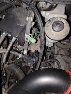

Picture 1:
There is no changes to this vacuum set up from the stock air box, to installing the aftermarket cold air intake. There was a vacuum line that was on the backside/bottom of the stock airbox; that should now go onto the nipple sticking off the cold air intake.

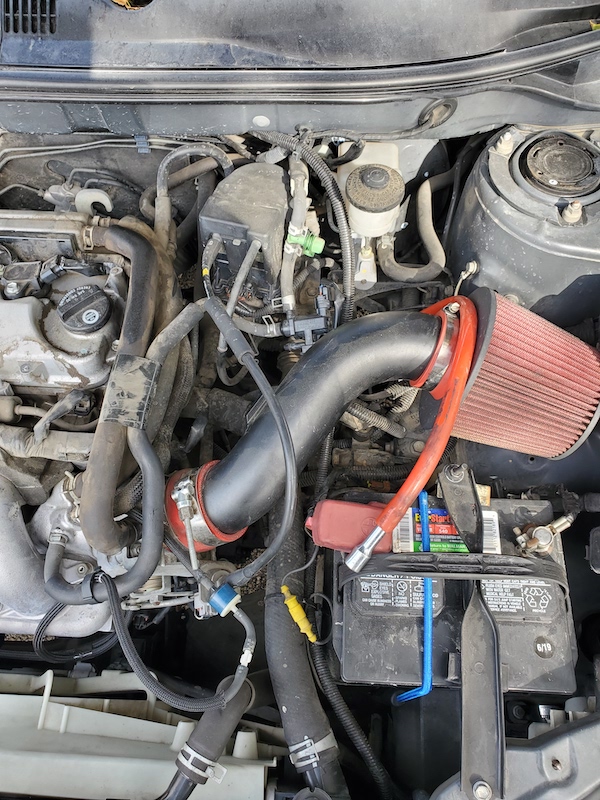

Picture 2:
The wiring for the brown solenoid is bundled in with either the positive or negative battery wiring. The solenoid itself is either pushed back towards the firewall near the first solenoid I picture. As this isn't plugged in for you, i can suspect that being part of your issue.
From that solenoid, I have both vacuum lines removed and don't have any codes thrown.

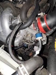

Picture 3:
One of the aforementioned removed vacuum lines ran to this spot just above the throttle body. Simple cap it off, and you will be fine... Zip tie was so I could identify it if I need to look for it in the future.
Hopefully this helps sort it out some.

zbyers wrote: ↑Tue Nov 12, 2019 4:20 am

Scratch that, I toughed it out and looked. So the vacuum line that you have capped off on the throttle body is currently running from that nipple on the throttle body to this part right under it. In the picture the vacuum line is the braided one.
I supplied this next picture to just see if you see anything different between mine and yours. I think its an evap system thing.
