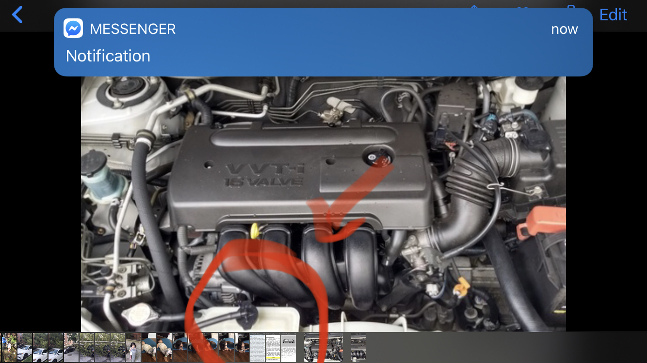

Here is the images from my tank. Harder to see because of the discoloration of the plastic but red more than anything else

The car came with Toyota red, use toyota red, or equivalent. I don't know if dexcool has changed, but at one point there were a reports of sludging issues when mixing dexcool and other coolants. Do not use dexcool in an 07. Not the way it should be, but trust us on this, not the dealerships.
Also, if that top pic is of your car, it's remarkably clean for a 13 year old car
I was going to mention that in the post! Disclaimer - this is NOT my car!! ;o)
I just got upstairs and forgot to picture where I drew the sample from!
I’m almost positive due to the colour it’s dex cool. The white colour plastic may make it look a slight shade lighter but when I look using a flashlight it’s orange.
