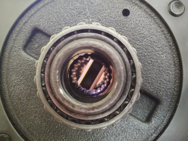

The forum software has a maximum upload file size, and digital cameras these days create files way above that limit, so sometimes you have to edit the pics to make them smaller. I took your pic, cropped it a little, then resized it smaller.
- diff0.jpg (63.81 KiB) Viewed 2698 times
What I see in that pic looks normal to me. There is a bar that runs across the interior that acts as the shaft for the side gears in the differential stage of the tranny.

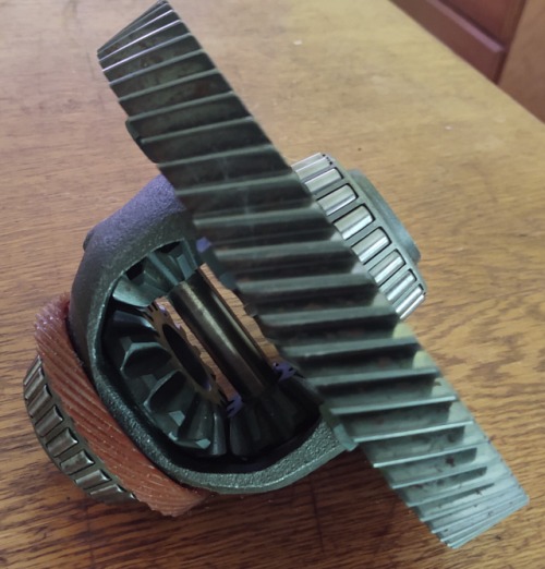

For example, here is a pic of that, this is from a dead 5-speed manual tranny, but the one in your auto tranny is nearly, if not completely identical

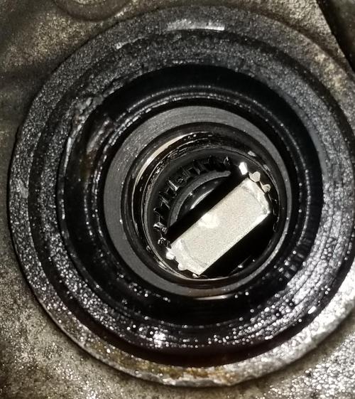

Here is another pic of that looking in where the splined axle slides in, pretty much the same view as in your picture
- diff2.jpg (64.92 KiB) Viewed 2698 times
I've never pulled the axle out of an auto Vibe, but I have on a 5 speed vibe, and if I remember correctly, there's a split ring around the tip of the axle shaft that serves as a retainer once it's fully inserted. Installing or removing the axle takes a bit of force to get that split ring to compress enough to pass through the splines
I found a youtube video at
https://www.youtube.com/watch?v=QkLBfXRDo1k, at about 2:30 in it shows the split ring I was talking about. Perhaps that video covers some critical step you need to get the axle back in.
