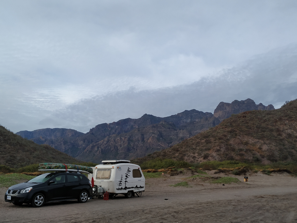

We maxed out our towing capacity on a recent trip and probably took off some life span on the vehicle as a result, but it handled well and didn't cause any problems as long as we watched the tongue weight and didn't let the load get too far back. We're looking at getting a dedicated tow vehicle for the future, however, as I'd like to be able to not worry as much about staying under the maximum tow capacity of 1500lb.

Re: Can the 1st gen AWD tow? You bet!
That is a beautiful picture. South Dakota?
MikeReilly
Posts: 32
Joined: Sat Oct 16, 2004 2:56 pm
Post by MikeReilly »
zbyers wrote: Fri May 08, 2020 6:19 am That is a beautiful picture. South Dakota?
If you are talking to me, no, it isn't South Dakota. It's Playa Juncalito just South of Loreto in Baja California Sur.
