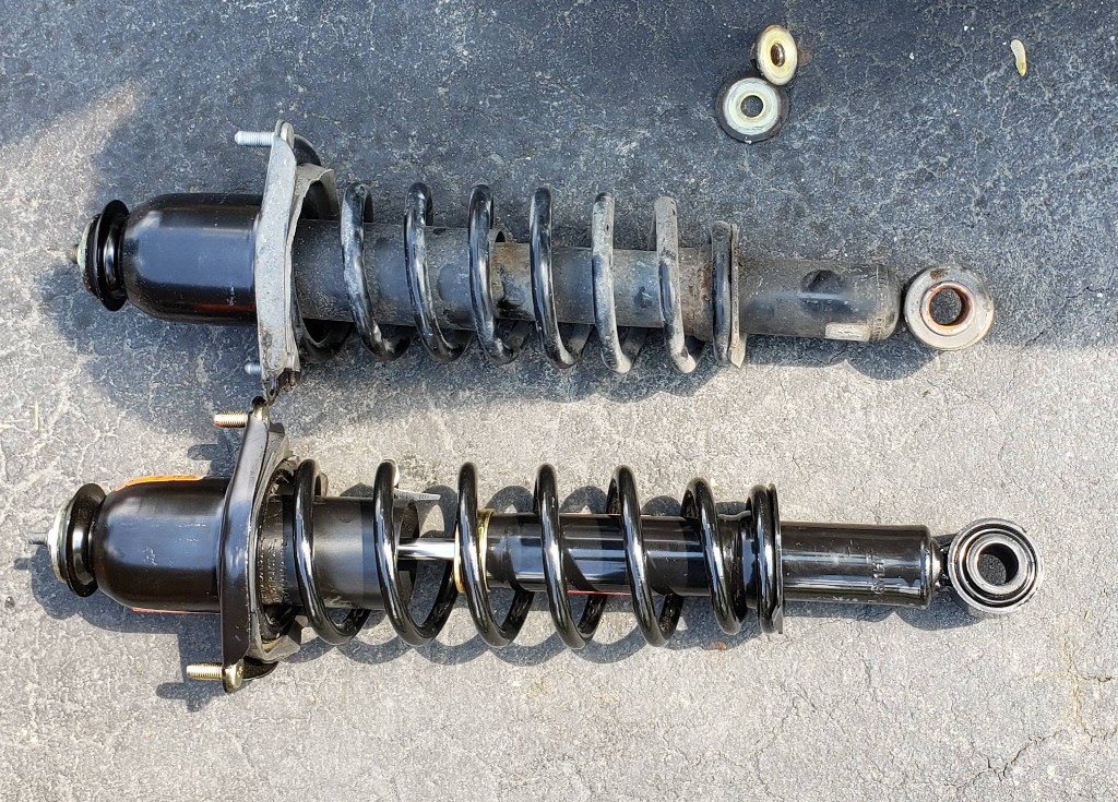

Trying to install a set of rear Monroe QuickStruts ( 171373L/171373R.) So far I only have attempted the right side.
First observation, the Monroes are considerably longer than the old factory units and that is causing me considerable drama trying to get them installed:
I'm having problems with getting the front stud in the hole and it's next to impossible to get the bottom on the stud there.
The only thing I've been able to do is place a jack under the strut and lift it up, which lets me get both top studs in. But then, the bottom is sitting crooked and will not go on the stud down there.
I've tried pulling down on the axle to so the bottom stud gets closer to the strut, but it's not enough.
I tried forcing it on with a few whacks of a rubber mallet and got it started, but then it was so crooked and tight all it wanted to do was eat up the threads on the bottom stud.
What's the trick I'm missing here?

Aanndddd, I finally got it.
Supported the axle with my larger floor jack. Stuck the strut studs through the top as best as I could. Used my little low profile 1.5 ton jack to go under the strut. Jacked the strut up, got the studs through then just fought with it until I was able to get the bottom stud through. A few good whacks with the rubber mallet and it was finally on.
Oddly enough, the driver's side went on MUCH easier. The original was a bear to get off, however.
Started around 10:00, now it's almost 16:00 and I still need to finish buttoning things up inside. "Quick struts." :lol:

Instead of doing one coil over at a time; if you would have taken both off the axle, the axle would have swung down further. That is why the second coil over went on easier then the first one did. You were kind of fighting yourself though the rear solid axle when doing one long coil over and one short coil over. Pulling down on the axle would do very little when the other side of the axle is held up by the short shock. The AWD rear would be different as you would not have a solid axle in the rear. Experience is a great learning tool to add wisdom to your years, provided we can still remember these things when we are old. ;)

Thanks for the advice and you're exactly right - I was doing a great job at fighting with myself!
It's always a learning experience. Everything worked out fine in the end and save for the front struts being trashed, the ride is quite improved. I'll be tearing into the front struts soon as well, so that will be interesting. :D
