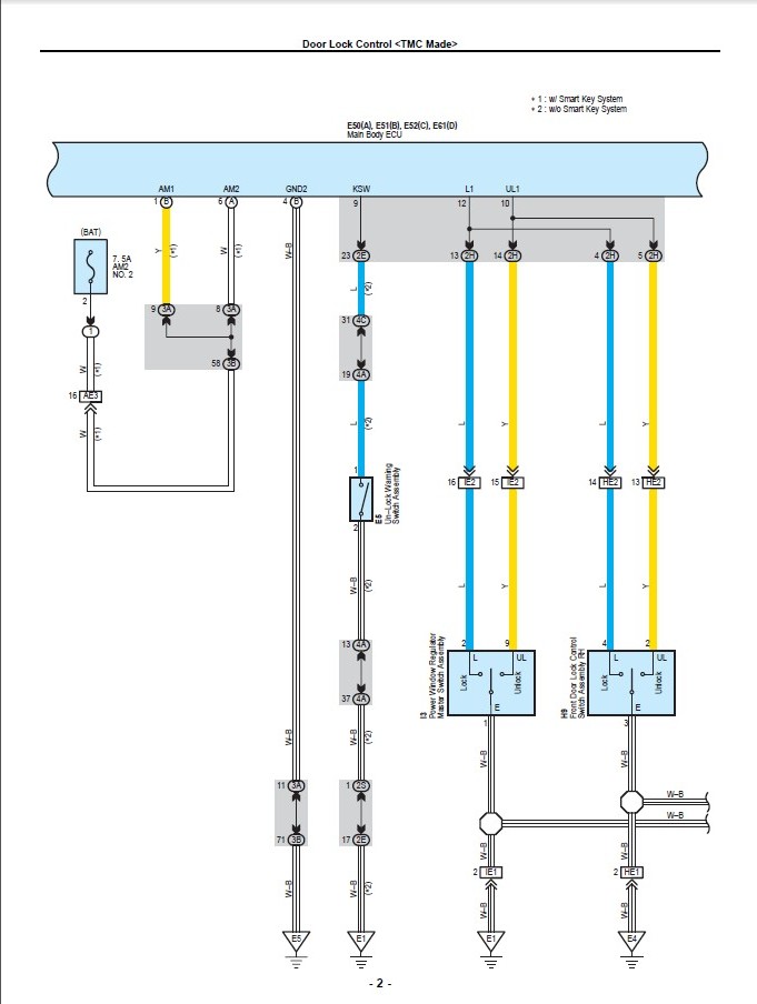

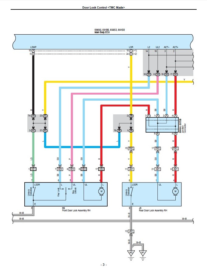

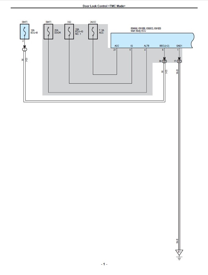

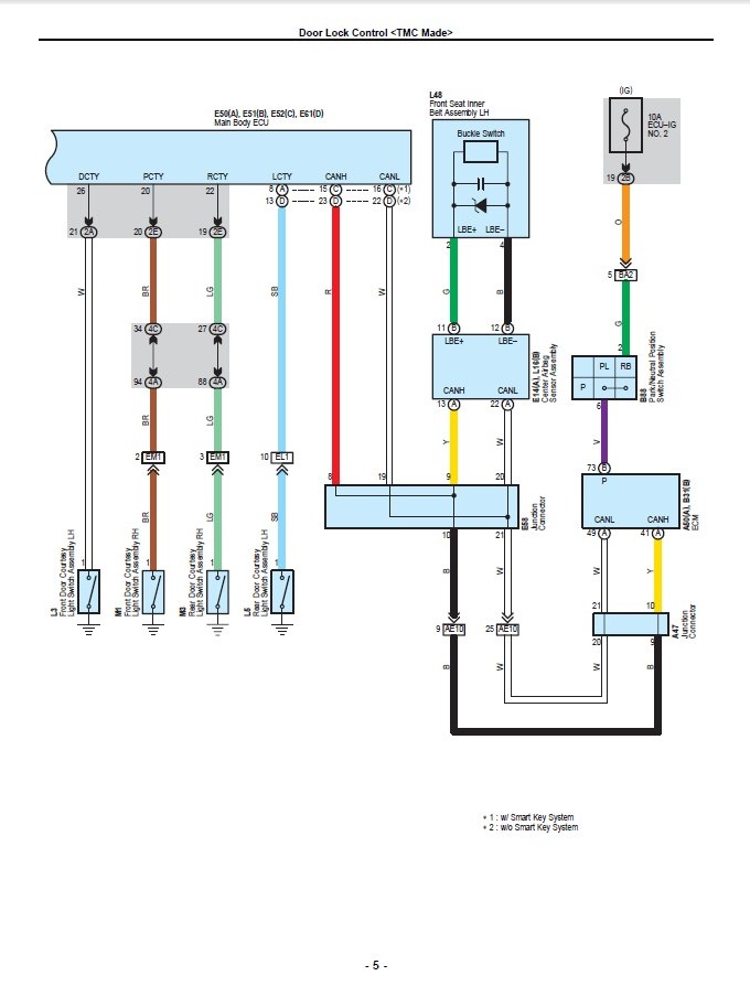

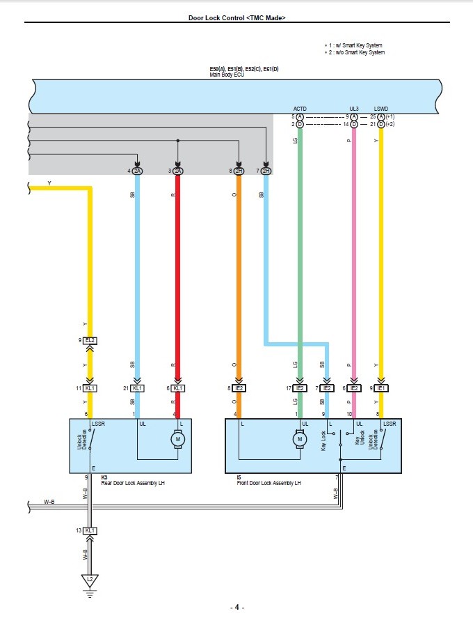

Attached are the wiring drawings for the door locks on a 2009 Corolla, which should be close to the same as the 2009 Vibe. Some wire colors may be off but the same basic wiring is happening for the Vibe. As shown there is no relay in the door lock system. Switch and lock motors inputs and outputs are controlled by the Main Body ECU in the drawings.
Do the locks work every time when using the key in the door handle lock for both front doors (not using the FOB)?
ECU's, for the most part, do not work some times and then work other times. I would say you have a bad connection or a broken wire in the system. The only way your going to find it is to start checking all the related wiring with a meter.
