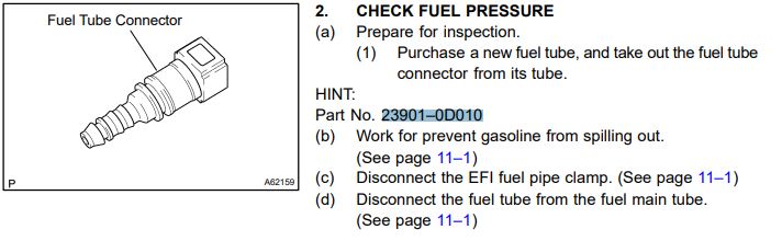

Thanks. I'm talking about first gen (2003). I wasn't about to cut the fuel line. The instructions here seem to indicate the connector comes out of the tube ("take out the fuel tube connector from its tube"):
fuel connector.JPG (37.9 KiB) Viewed 45786 times

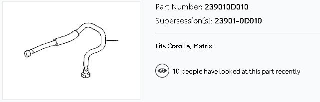

And the tube they want you to buy is this
fuel tube.JPG (22.49 KiB) Viewed 45786 times

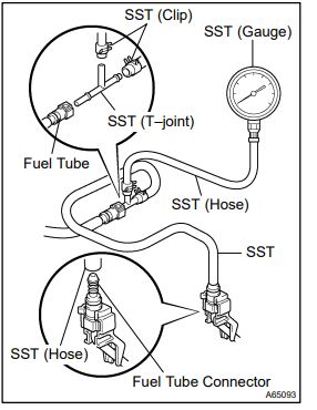

And the setup looks like this
fuel SST.JPG (30.87 KiB) Viewed 45786 times
In any case, there are two ends to that fuel tube, and I can imagine setting up a pressure gauge at either end. But the key to me seems that this indicates the fuel tube connector comes out of the tube. And if that's the case I should be able to take it out and use a T with a generic test kit... perhaps.
