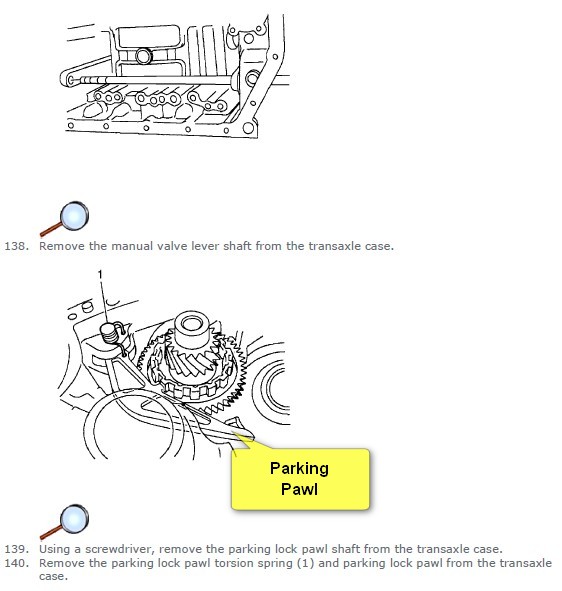

Here is a break down of the parking pawl location in the 4 speed. There is some internal linkage that can be seen when the valve body is removed, but you can not see the pawl assembly. If the valve body is removed, be very careful as the info I have shows a couple of pistons and springs that will fall out of the transmission case when the valve body is removed. This would be best done on a bench. I will see if I can get breakdowns on the linkage inside for you.

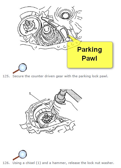

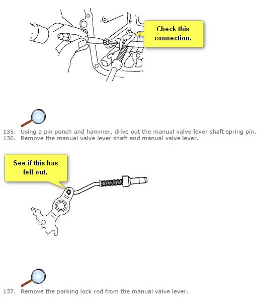

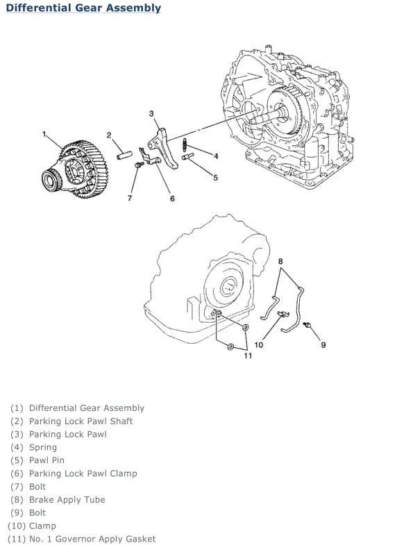

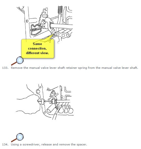

Here are more pic's. Also note that there are two different models of four speed transmissions used in the second gen Vibes; the MVA model 4 speed and the MVB model 4 speed. You have stated which 4 speed you have. The above or first pic I posted is for the MVA 4 speed. The pic's I post below are for the the MVB model 4 speed. The info posted is part of the disassembly of the transmission when the transmission is removed from vehicle and is being worked on on a bench.

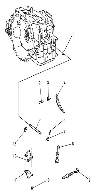

One more for the MVB:
