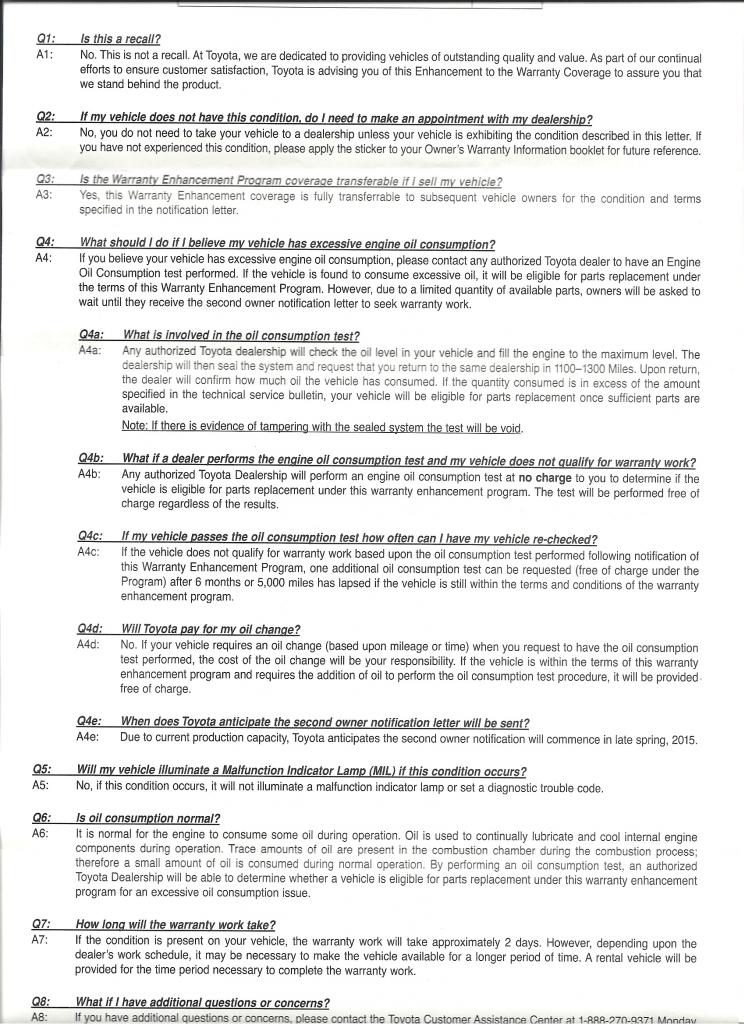

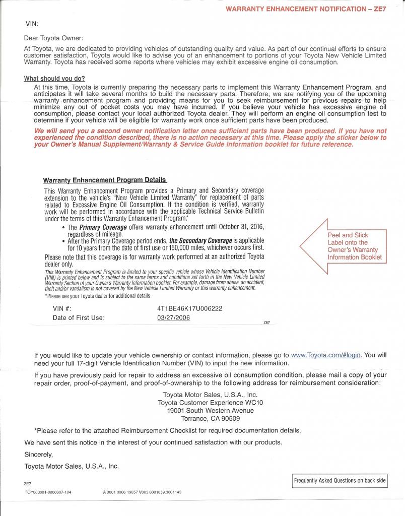

Although I am not certain of the assembly origin of the 2.4 Liter engines used in the Vibe, apparently Toyota has recently (January 4, 2015) issued a special 'Extended Warranty Enhancement ZE7' for the 2.4 Liter 2AZ-FE engine used in the their Camry, Matrix, Scion, Corolla, RAV4 models. I assist an elderly neighbor with the maintenance & repairs on his Vibe and I recently received information on this 'non-recall' fix for excessive oil consumption involving the oil return holes under the oil control rings on the pistons in the Toyota 2AZ-FE engines. If the engine in question fails the oil consumption test, apparently Toyota will replace the pistons and rings under their TSB-0094-11 http://assets.carcomplaints.com/docs/to ... 094-11.pdf. Another description of the program can be found at: http://www.toyoheadquarters.com/threads ... c-ze7.362/
Again, not being certain of the assembly origin of the 2.4L Toyota engine used in the Vibe, as only engines made in certain plants are covered under this notice, this information may be potentially useful to Vibe owners experiencing excessive oil consumption with this type of Toyota powerplant. Happy Motoring!
