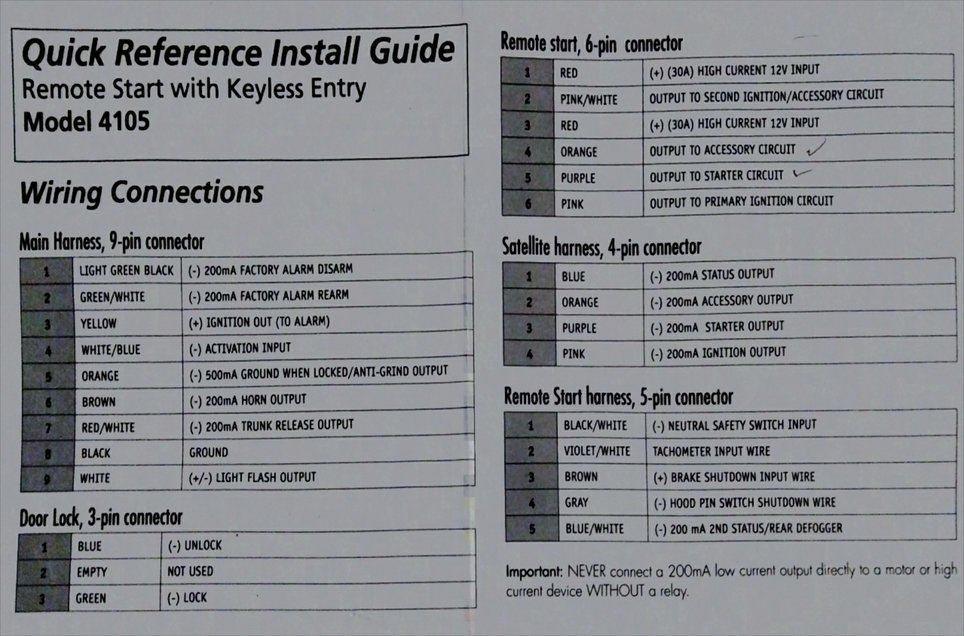

I have had an Avital 4103LX in my closet for a year and a half
I've seen several posts on the forum about installing a remote starter. So, through videos and various posts, I pretty much know where to connect all the wires and the process of how to mount the components.
What I don't have is confidence that I know there right wires to connect. Could somebody with experience with these things confirm my plan. I've pieced together a Google Sheet, based on the Bulldog wiring diagram and the applicable wires from the Avital Diagram on the far right.
I've also attached a picture of the Avital Wiring Connecction sheet. (It says 4103LX on the box, but it came with 4105 chart?)
https://docs.google.com/spreadsheets/d/ ... sp=sharing
EDIT: Updated link to spreadsheet.

If I don't mention it, it looks fine...
1. you can catch your 12 VOLT CONSTANT in the ignition column of your car. It will be a WHITE heavy gauge wire and will test +12v at all times.
2. your PARKING LIGHTS can be caught one of 2 places. Either in the kick or at the switch. Just make sure the jumper on the 4103 is set to the proper polarity.
3. You have TYPE B door locks, so you don't need to worry about the LOCK MOTOR WIRE.
4. Your HORN is optional and not necessary to operate.
Also, one thing you left out. You will need to ground the NEUTRAL SAFETY SWITCH of the 4103 or the unit will not remote start.
Lemme know if you have any other questions.

So frustrated. I swear everything is connected correctly.
Main harness, 9-Pin
1-6 not connected.
7 - pops trunk when grounded (no relay needed)
8 - grounded
9 - I accidentally blew fuse, but its wired to the green/white at the switch. I accidentally hit it with my + probe when testing. How would I actually test this? Continuity with ground when parking lights on?
Door lock, 3-Pin
Voltage drops to 0 on appropriate when actuated by key in the door.
Remote start, 6-pin
All wires connected and appropriate readings at the harness.
Satellite harness, 4-pin
Not connected
Remote Start, 5-pin
1 - grounded
2 - AC reading at idle
3 - loses continuity to ground when brake pressed
4-5 Not connected.

Lets start with the basics. First off, the 4103 should come pre-programmed to the remotes, so it's doubtful it's that...
Does the 4103 make ANY NOISE at all when pressing the lock/unlock buttons? You should hear the relay inside the unit clicking once (lock) or twice (unlock). If not, then you don't have either main +12v power or ground correct.
For the parking lights, if you're using the (-)green/white wire, then if you ground it out, it should turn on the parking lights if you have the correct wire. Vice versa if you go for the (+)green wire. If you touch the green wire to +12v then it should turn on the parking lights.
Door locks should be +12v at rest, then like you said, will drop to 0v when actuated by the key. Again, if you have the correct wire, if you ground it out will either lock or unlock the doors.
4-pin satellite harness is useless. Throw it away.
+brown brake shutdown wire should be connected to the wire that goes +12v when you press on the brake.
If by some chance it didn't come pre-programmed at the factory, you can always look in the guide on how to program them. It's a pretty simple process.

What is the bare minimum that needs to be connected to get signs of life (relay clicking when lock/unlock pressed)?
Ground, power, antenna. Anything else? Please be explicit, exact pins.

Red out of the 6 pin goes to +12v constant, black out of 9 pin needs to go to ground. Plug one end of the antenna wire into the 4103 and plug the other end into the antenna receiver. From there you should hear the internal relay for the parking lights click when pressing lock/unlock on the keypad.
If anything, test by touching the wires directly to the battery in the car.

Didn't want to start a new post since the diagram is the same as mine, I thought this would be the best place.
I'm installing a 4105 in a 2009 Base Vibe with a 2.4L. I've searched a lot of sites and am pretty certain I have all the circuits identified correctly.
The lock and unlock buttons on the remotes activate the door locks just fine.
When I hit the remote start button, my vehicle unlocks (1st issue) and then the ignition is activated and the entire dash comes alive. It appears as though it's trying to "start" the car, but it's not activating the vehicle Starter circuit (2nd issue). It tries this 3 times and then locks the doors and shuts down.
I hooked up the 3 pin connector (door lock (Green) /unlock (Blue))
to the Purple (power lock) driver kick, white 18 pin connector, pin #16 and
to the Tan (power unlock) driver kick, white 18 pin connector, pin #15
and
the 9 pin connector - factory alarm disarm (light green black) and factory alarm rearm (green/white)
to the Pink (factory alarm disarm) - driver kick, white 18 pin connector, pin #6
to the Black (factory alarm arm) - driver kick, white 18 pin connector, pin #7
Not sure if the above is affecting the unlocking during remote start or not.
For the starter circuit, I only connected the Purple wire from the 6 pin connector (output to starter circuit) to the large gauge Black wire in the ignition switch connector.
I haven't put a probe on this black wire to see if it's getting any signal or not.
Any ideas? Vehicle starts and runs but the vehicle interior is all tore apart and I'd really like to get it to work.
Many thanks,
John
