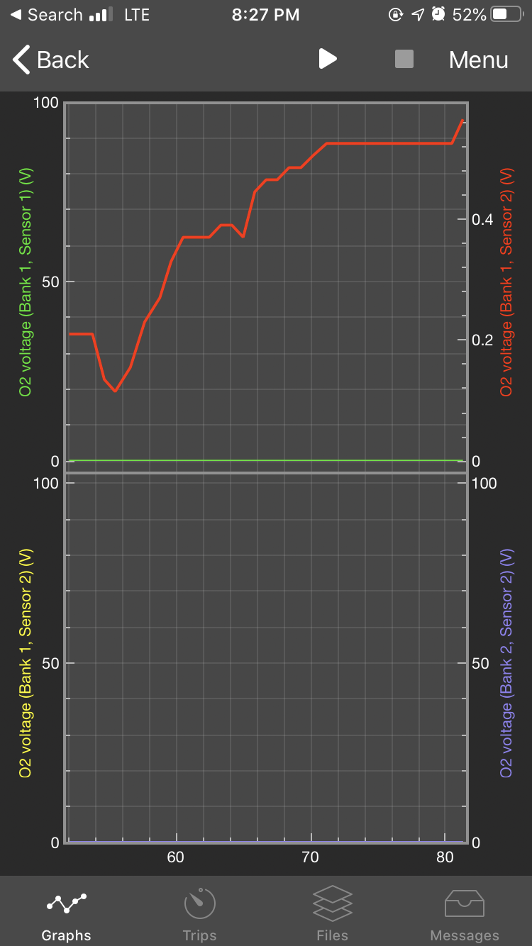

P0420 typically means your converter is below efficieny thresholds. If you have a bluetooth code reader, hook it up and look at the o2 sensor graphs. If they make nice "waves" the o2 sensors are fine. It would then be your cat.

So bought OBD Fusion (and they have IAPs?!) and took a look at my graph. I'm going to go out on a limb as and say that O2 sensor 1 is bad. Bank 1 sensor 1 was a flat line at 0V, Bank 1 sensor 2 was going between .1 and .5 V.

This may help. It shows the good and bad patterns and how the trace the cause down. After checking wiring and connections for the sensor output and heater, check for air leaks in the exhaust system.
